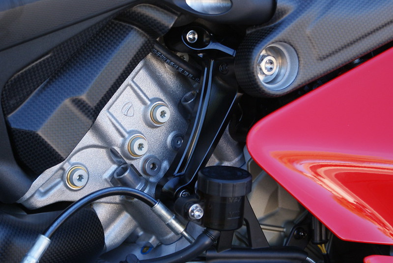

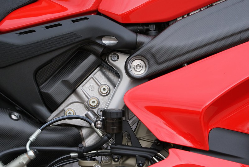

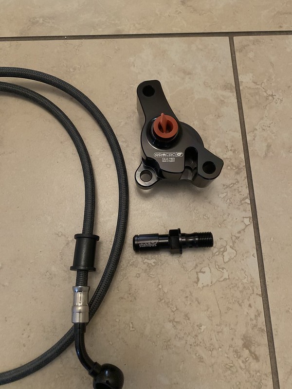

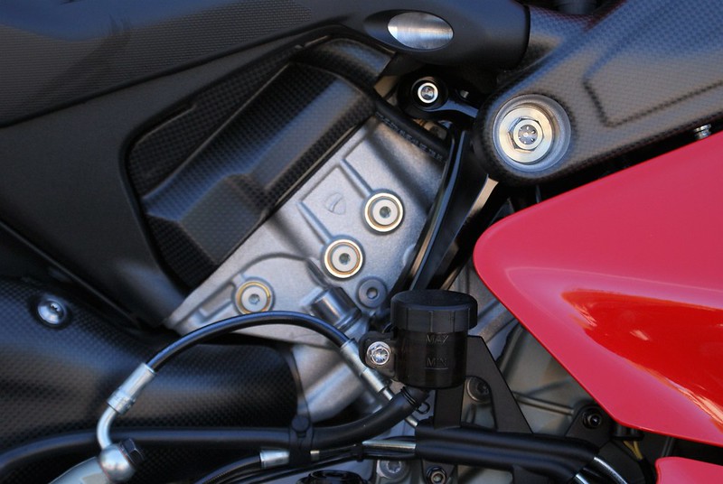

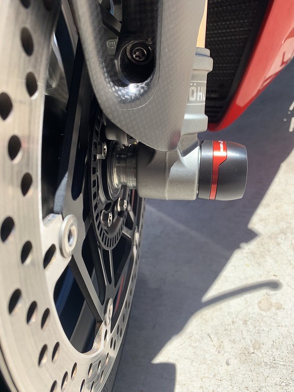

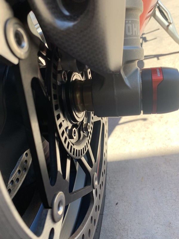

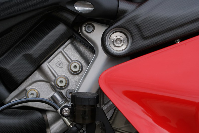

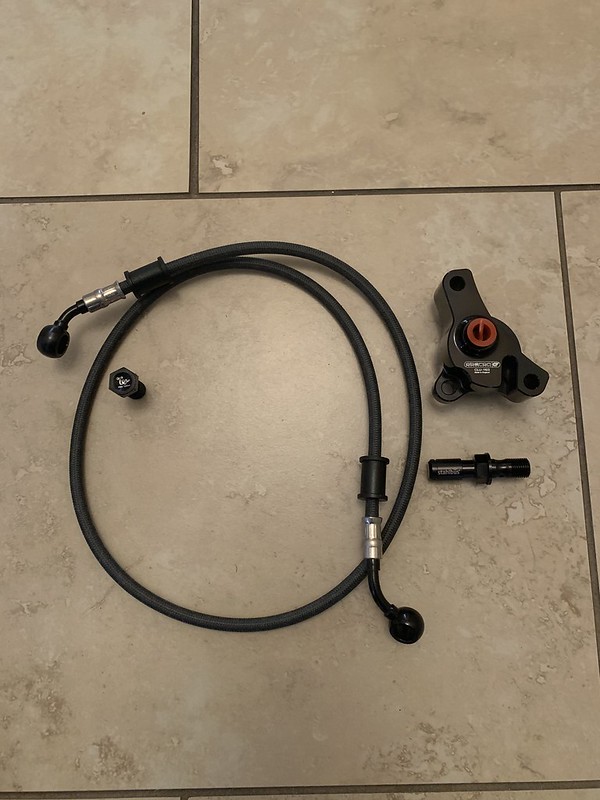

Yeah the whole servo was removed. I didn’t ride it so I don’t know if it had any errors.Hi HKMP7,
Quick question, when you install your Akrapovic Full System Exhaust, do you took out the whole servo assembly? if you did took out the whole assembly,
did it show error warning on the dashboard before you reflash with the Ducati Akrapovic new MAP at the dealership?
Thanks
Thanks for the information HKMP7, that is really interestingYeah the whole servo was removed. I didn’t ride it so I don’t know if it had any errors.

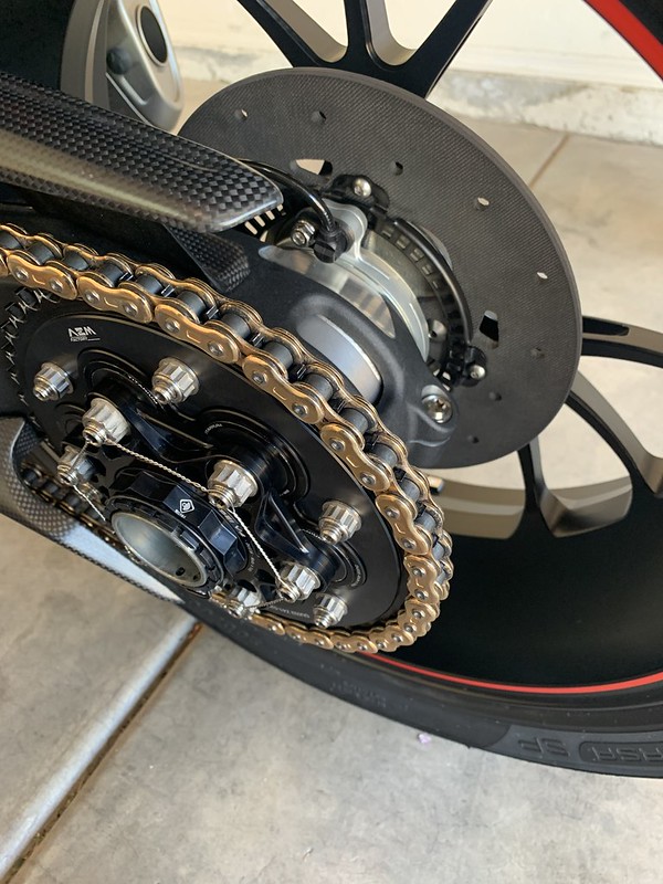

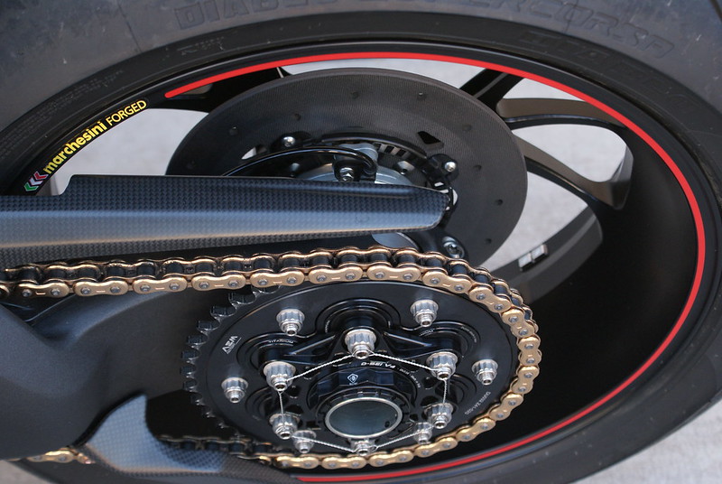

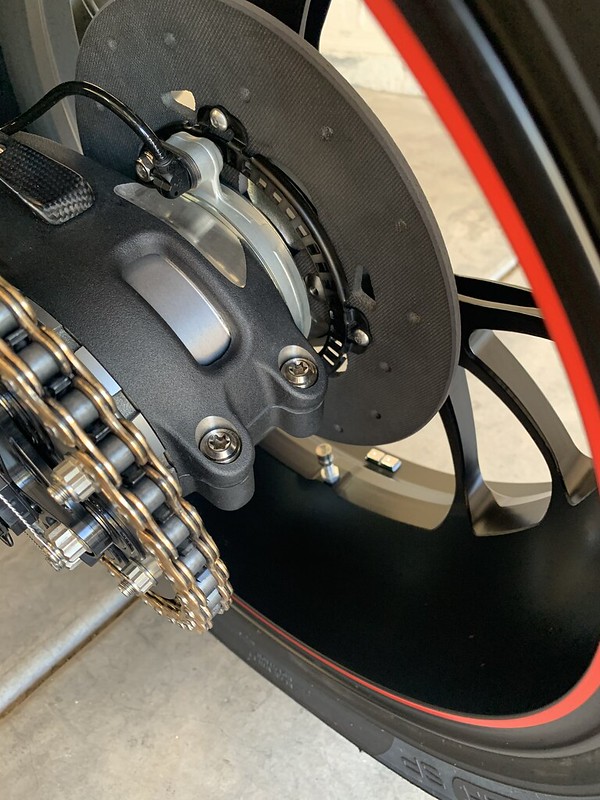

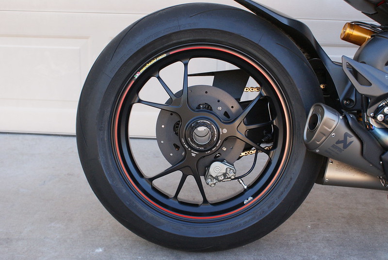

Hi HKMP7,Sicom rear rotor

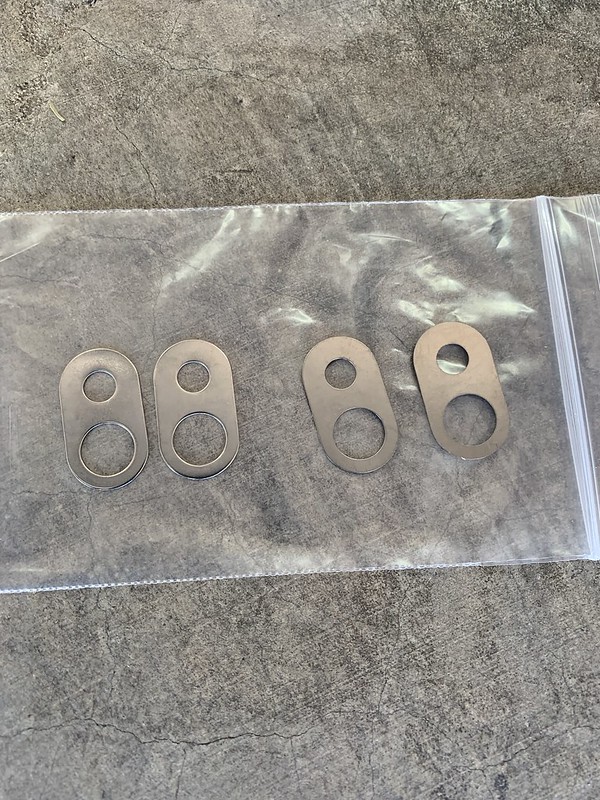

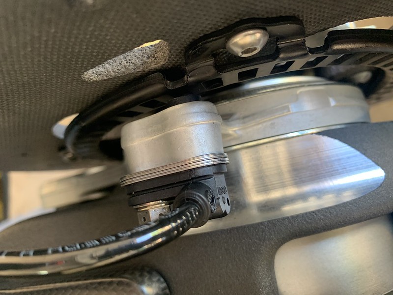

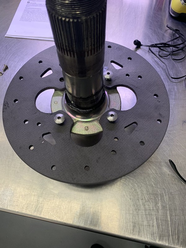

This thing is pretty trick. Some stuff to note. It comes with pads which will work in the factory caliper or brembo billet caliper. Uses different size rotor bolts and abs ring hardware. (Comes with rotor). The ABS ring is held on with a bolt thru the front and nut on the back.
The rotor measured .9mm thicker than stock. So I got these abs shims to remedy that.
ABS ring shim .2mm part # 71314901A
ABS ring shim .5mm part # 71319201A
I used 1 of the .5 shims 2 of the .2 shims.
Worked perfect no issues with TC.
My girlfriend said I could have used this instead of buying those shims lmao
Weight difference
Stock rear rotor 1014g
Sicom carbon rear rotor 359g
655g or 1.44lb savings
It was silly fast before and its still silly fast. So I didn't notice a drastic difference. The braking force is the same as factory I can still do sweet skids.Hi HKMP7,
That is a huge differences in unsprung rotating weight. Do you feel the difference in acceleration? Also, how is the carbon rotor/pad perform compare to the stock rotor/pad in braking performance?

Just saw this post. @BMWAlpina. Everything disconnected on my install and no code comes up. But that is a 2012 1199S.Yeah the whole servo was removed. I didn’t ride it so I don’t know if it had any errors.
