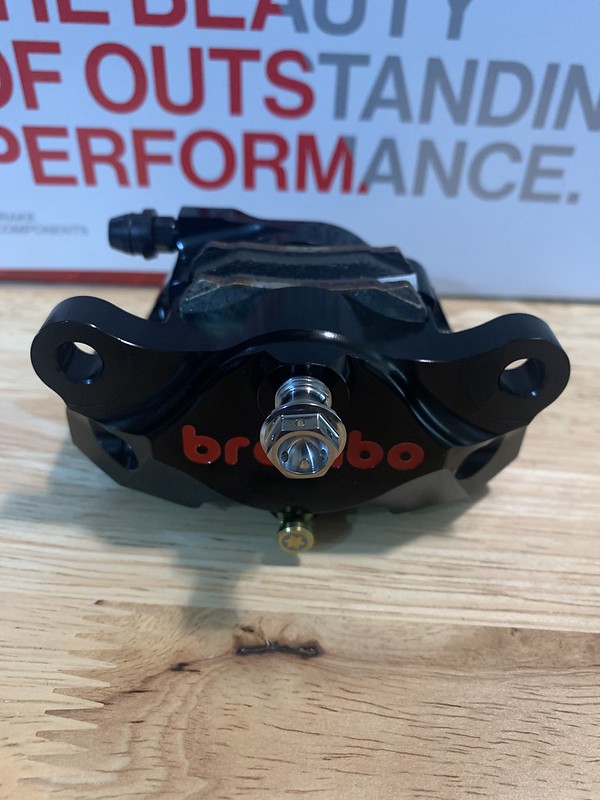

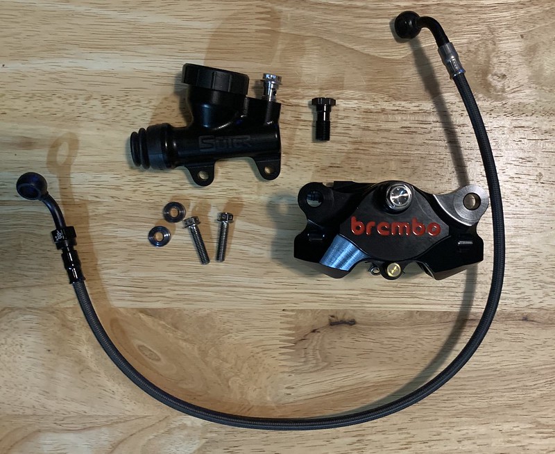

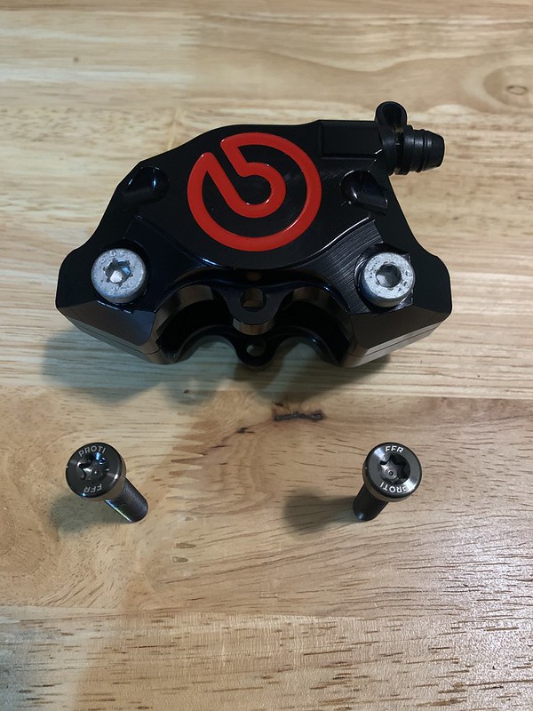

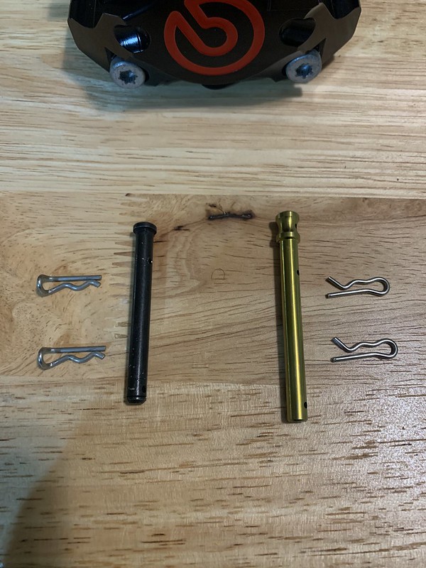

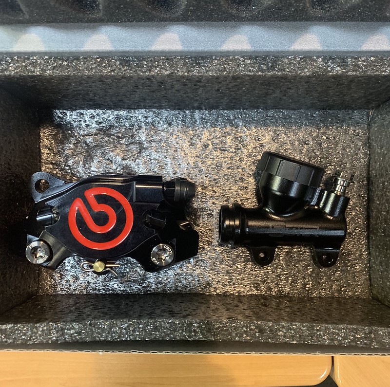

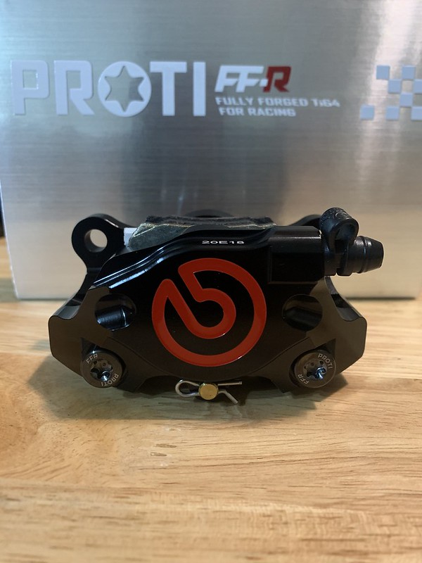

I got some stuff for the billet rear caliper and I think it turned out nice.
Proti caliper pin
It comes with the retainer clips

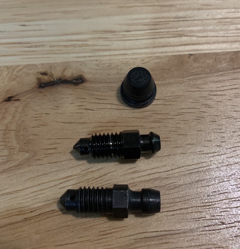

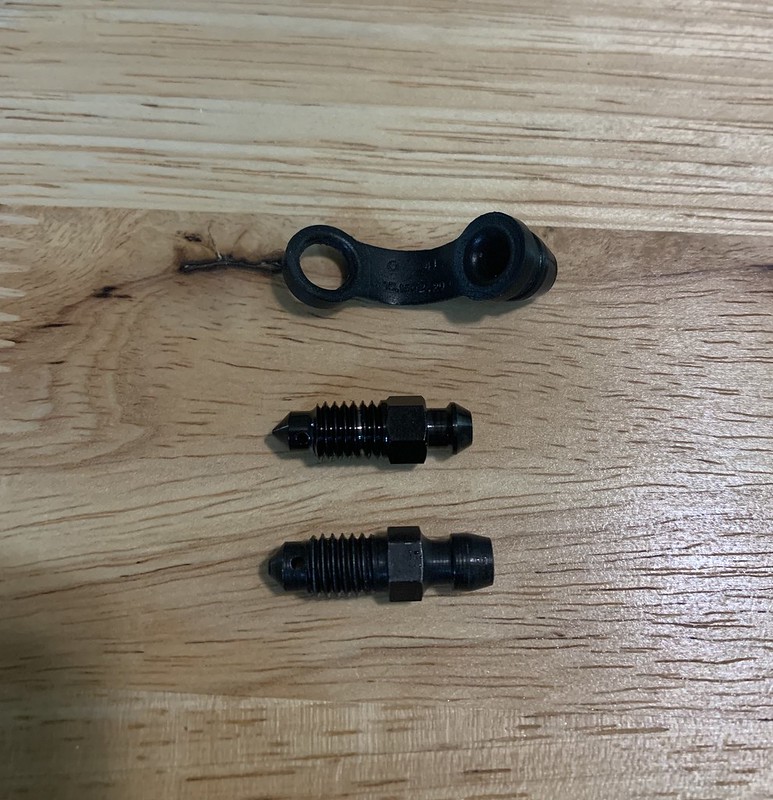

Replaced the bleeder as well
I modified the dust cap to accommodate the shorter bleeder.
Probolt Ti banjo bolt and bleeder installed

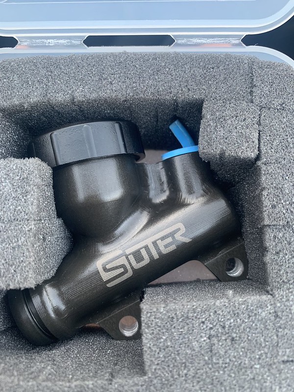

Suter Racing Rear master cylinder

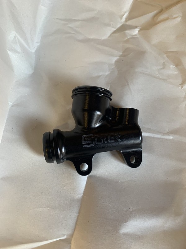

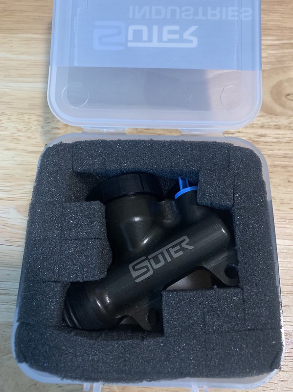

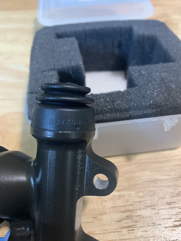

Another piece of the puzzle for my braking system. Suter is well known in racing mostly for building swingarms, slipper clutches and full blown MotoGP bikes. Here's my attempt to clean up and simplify the right side of the bike. This will integrate the master cylinder and rear brake reservoir. Normally this master comes with threaded mounting holes which wouldn't wouldn't work with the V4 rearsets. So I asked them to "modify" it for me by removing the threads. This is "Ducati Modified" forum and that's what we do. They replied no problem and sent me out this.
You can see this is made by Brembo for Suter :cool:
My only issue is the color which you can see here in the sunlight. I have plans for that but more on that later.

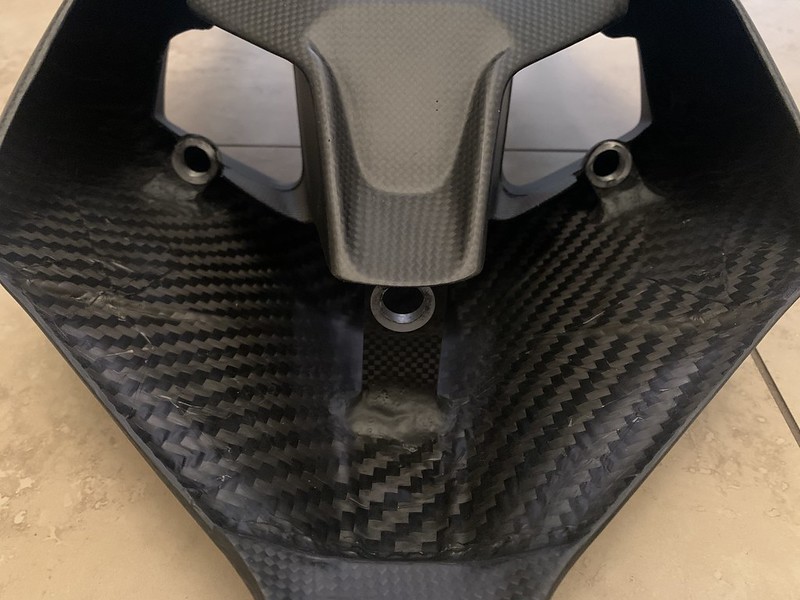

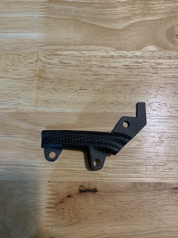

The factory reservoir bracket helps with brakeline routing. When I delete it I will have a problem with cable management.

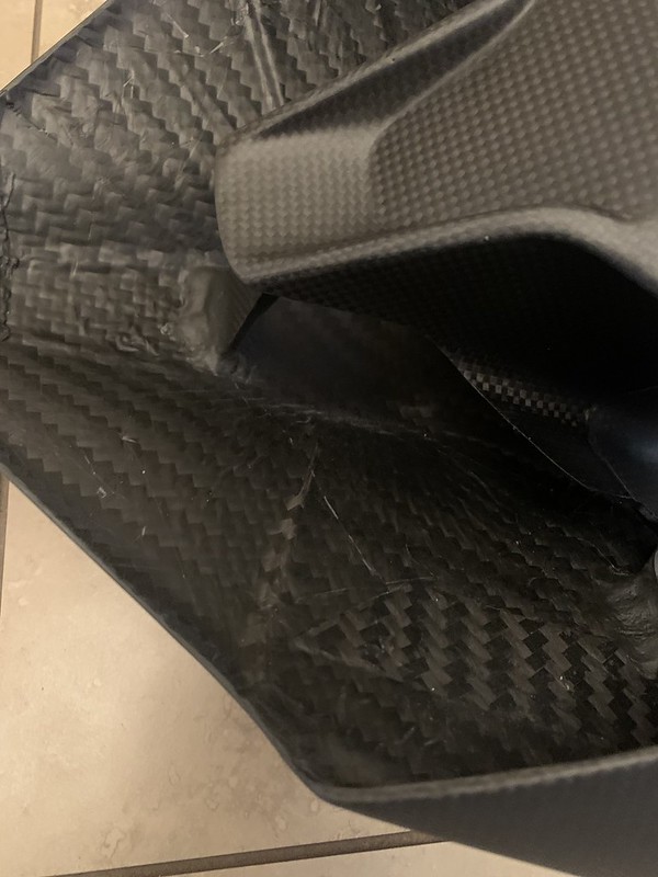

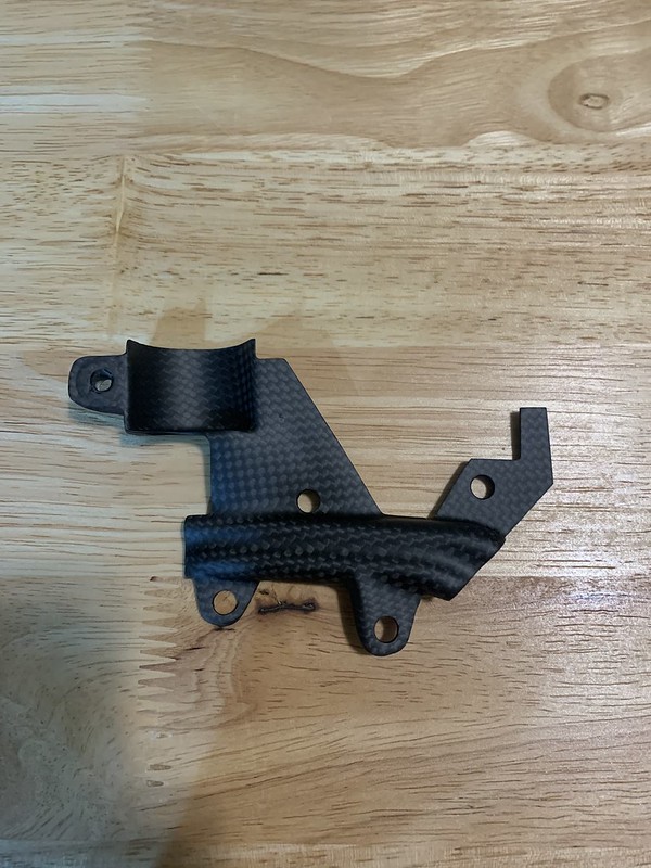

Here's my solution I bought the Fullsix carbon reservoir bracket.
I chopped it up.

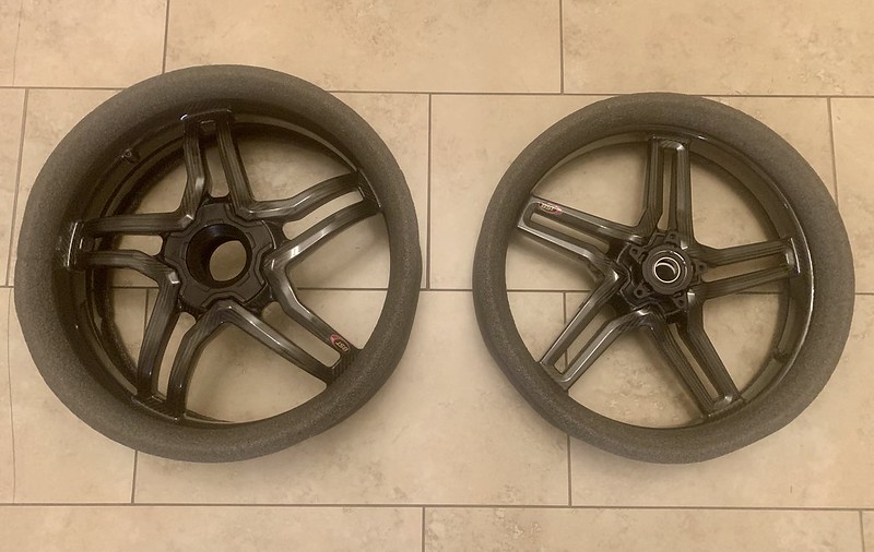

BST Rapid Tek Carbon Wheels

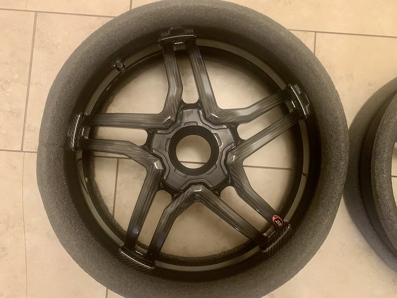

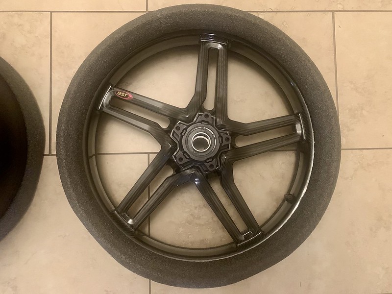

When I first saw the V4SL I was thoroughly impressed. The extra effort they put forth just because they can is amazing. After experiencing the bike in the flesh I was in awe of all the details. I will not be one of the 500 lucky owners but I will use the bike as inspiration. BST makes the wheels for the V4SL since that design is only available thru Ducati. I got the next best thing the BST Rapid Tek.
These are gloss with ceramic bearings.
Hi HKMP7,
That is a great choice on the color and finished of your BST Rapid Tek, I saw some in other color, but I don't think any other color can look better than natural carbon fiber color for a carbon fiber wheel, at least for me :)
By the way, the ceramic bearings were optional, right? What are the advantages of using the ceramic bearings? Thanks
Hi HKMP7,
I agree glossy carbon is hard to beat. I considered satin but I felt like they wouldn’t pop as much. Yes the ceramic bearings were optional $150. The ceramic bearings offer lower rolling resistance over the standard steel units. So they will slow down and speed up faster. 😎

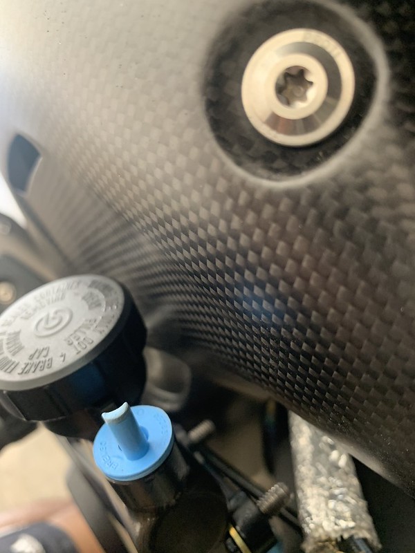

I test fitted the Suter rear master and I found a couple small things that need to be addressed.

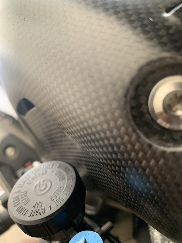

First I need to space it out about 2-2.5mm so it clears the carbon exhaust shield and the rear master pin is at the correct angle.
I mocked it up using 2 washers and it works perfect.

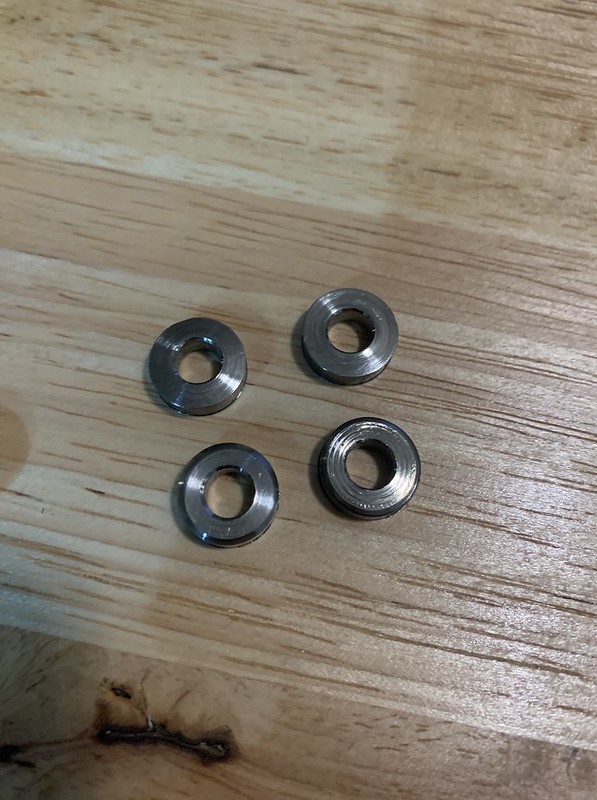

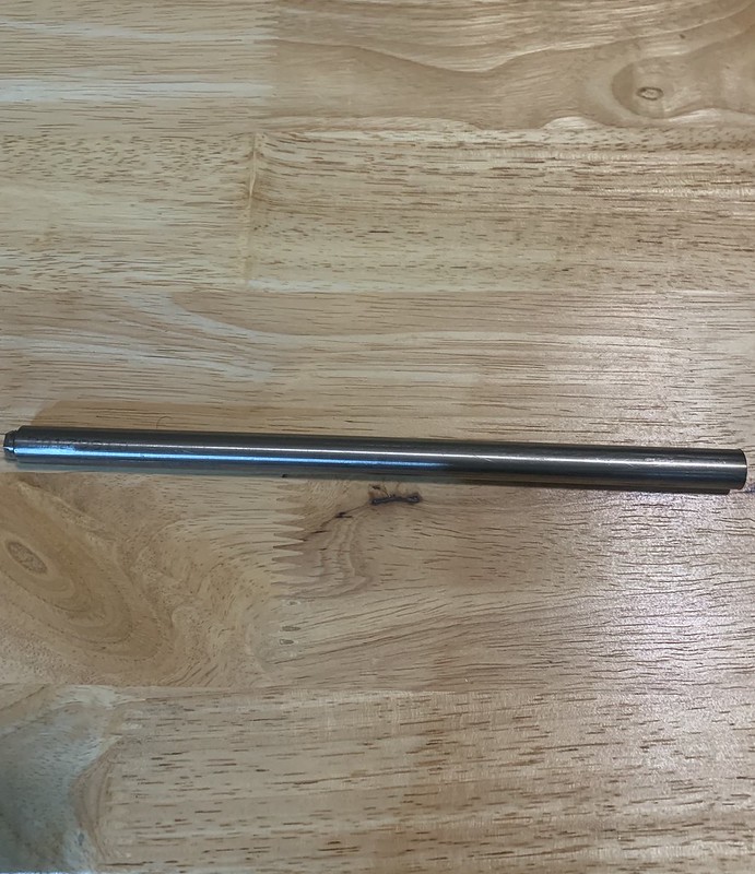

I found a much better solution to space out the master. I bought some titanium rod stock to make some custom spacers.
Finished product

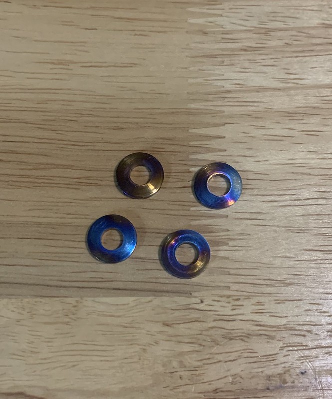

Extra touch I "blued" the spacers lol

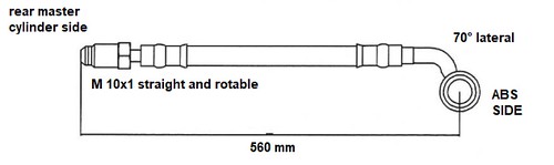

Second the brake line that comes with the Fren Tubo kit threads directly into the factory master so it wont work.
This is the line that comes standard with the kit.
So I have to get a custom line made. The banjo bolt on the new master is slightly farther back so I will need to extend the line. After measuring twice here are the specs for the new line. Carbon fiber brake hose 570mm long (from center hole to center hole) with a 45deg rotatable fitting on one side and 70deg lateral non rotatable on the other side.

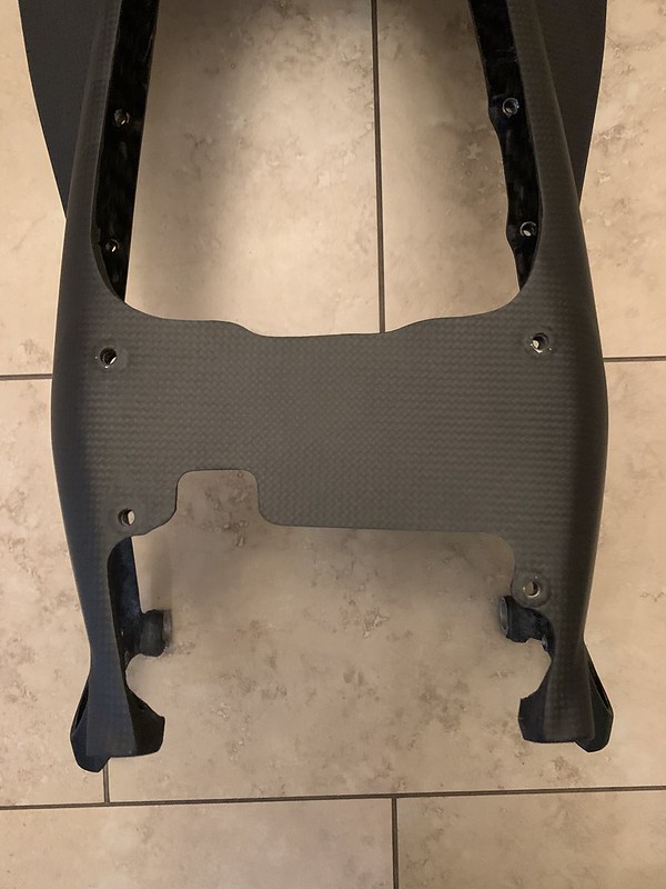

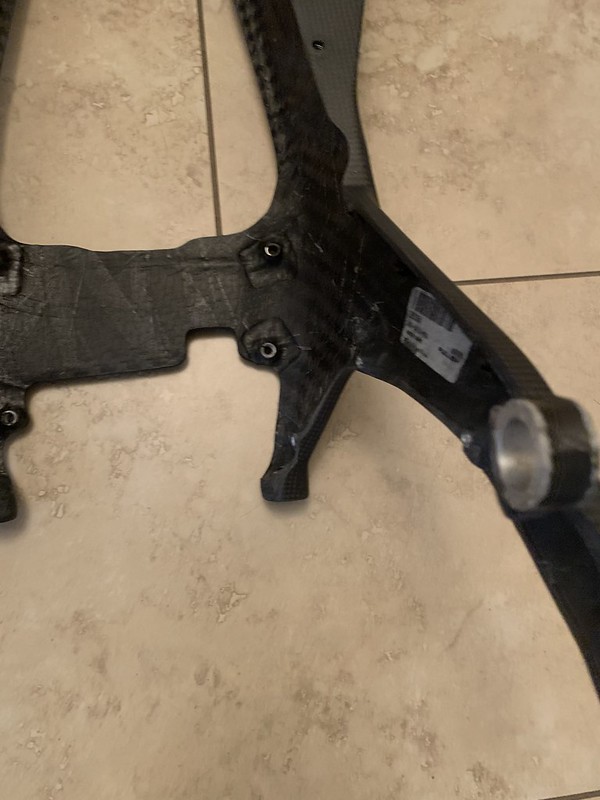

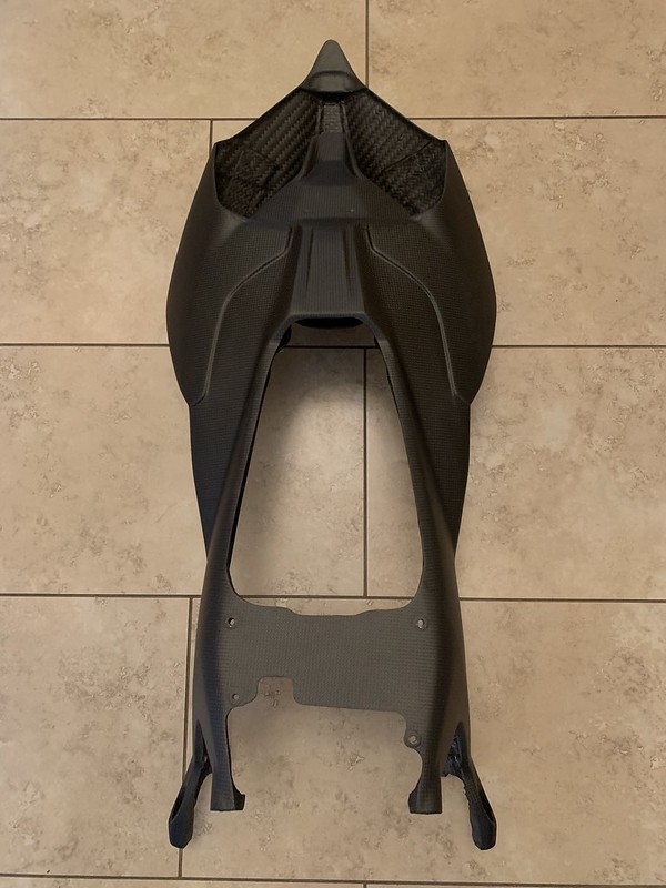

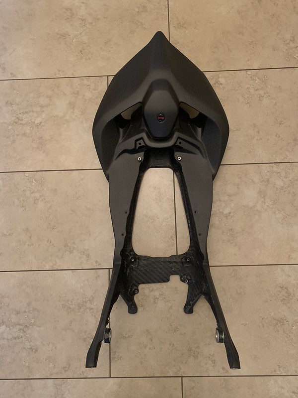

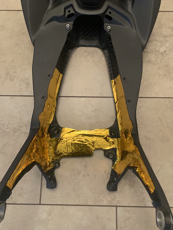

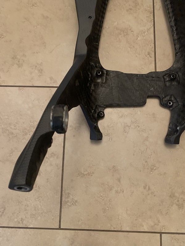

Fullsix Carbon subframe
In my quest to lighten the V4 this was a no brainer. Not only does it look amazing it will lower the weight and center of gravity. Once I install it I will share the data. For now enjoy the art that Fullsix has provided.

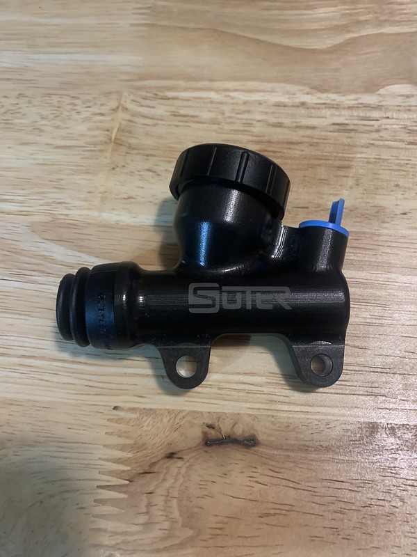

Rear Master & Custom Fren Tubo line update
I couldn't live with the brownish color on the master so I had it stripped and anodized. After the first chemical strip the laser etched logo was still there. They asked if I wanted to have them strip it again and I said no. I think it turned out awesome it gives it that "race worn" and more subtle look.
The color is a bright black hard anodize. I gave them a spare part from my rearsets for them to match.
Then put it back together.

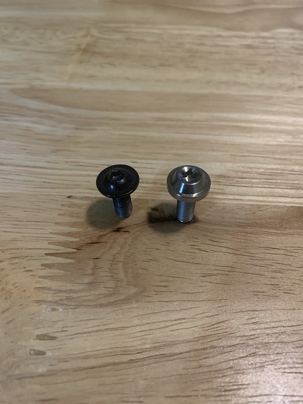

I painted the silver crimped area that's visible black.
I replaced the bolt that holds the brakeline to the swingarm with a Proti.
