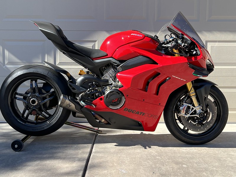

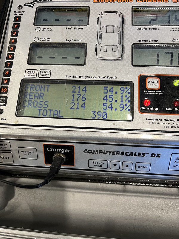

The SLV4 frame and swingarm will get you to the 400 range.So, where to begin. I am swapping out the front and rear frames for the SL4 carbon frames. I am assuming this alone will not get me down to this weight. The rotors seem to be the big difference as I have carbon wheels already. Perhaps the dry clutch too? Did that as well as well as carbon fairings.. where else do you recommend I try to lose some more weight?
Fast is always relative lol. My race bike has 4 more HP and weighs less so no ha ha.Does it feel exceptionally fast?
Correct they weigh between 440-442lbs full tank of gas.That’s crazy! Awesome result. That must be about 40-50lbs less than you started with?

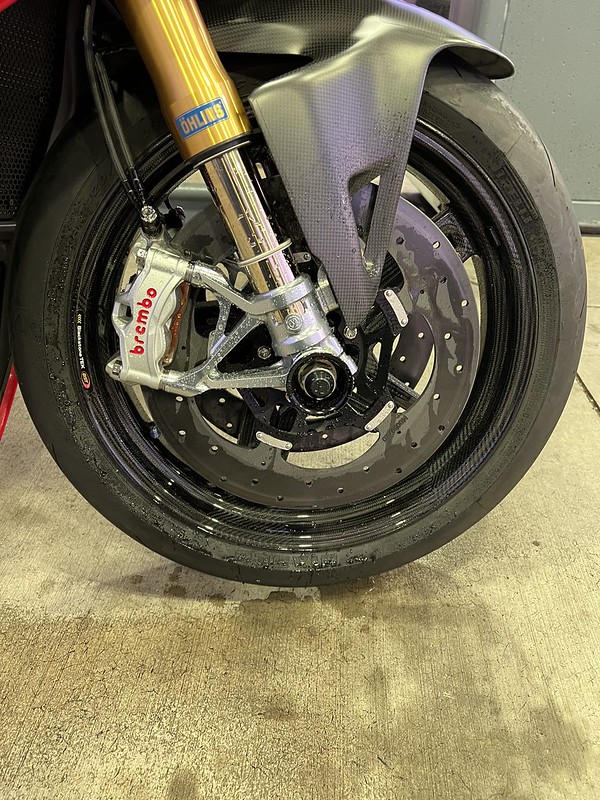

I need to get the rotors and pads bedded-in. Since I don't have any track events coming up I will have to bed them in on the street. Sketchy af lol. I loaded up my backpack with a pump sprayer more on that later. I decided early in the morning would be the best time since there will be less traffic and no. To my dismay there were
everywhere lol. So in between my sightings I would bed the brakes. After the 10 stops from 50 mph which were easy I started on to the 100 mph stops. I now have somewhat of a lever and the bike stops decent. The initial bite isn't like the Braketech Iron rotors but these ramp up like crazy. During the 100 mph stop the ABS would activate which I've never felt on this bike. Its not unsettling like other ABS systems it was a slight nudge on the lever as oppose to it fighting you. I let the brakes cool down and now we are in the home stretch. 2 more 100 mph stops then I ended up at the gas station here's were the pump sprayer comes into play. I go inside and purchase a large Fiji water I filled my sprayer with half and I drank the rest. Sprayed down the brakes to cool them off. Only the best hydration for the Sicoms lol. I could only imagine what the people at the gas station were thinking wtf
Now that the brakes are good to go they feel great I've put about 100 miles or so on them and they stop stop.
I'm ready to out brake Toprak Razgatlıoğlu into turn 1 at Jerez. I will put more miles on them and do a proper review. Initial thoughts are positive.
