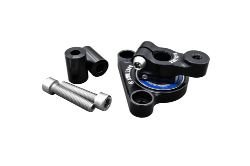

Ahhh. That was a common mod with the V2 platform back to the 1199. That's definaetly cheaper than the billet covers made to do the same thing.
But, I don't think that's going to help your problem, since your problem is with the electronics.
dunno, but I’ll try and I willdiscuss with work today to action a warranty on the unit
PanigalePilot
it supports the quick shifter shaft
Never heard of one of those. I have an 1199 and the QS up only always works perfect. Tuneboy adjustment cutback the fuel cut from 100ms to 50ms which works great. That Racetork thing just looks like a bracket to me so I doubt will have any effect on the fuel cut for downshift. In my humble opinion having been around the Panigale now since 2012 and trying all sorts of things (not QS though) I think sometimes we get kinda conned by marketing and FOMO pressure to get the latest and best when the factory have already done that for us when they design the bike.
If you have factory QS up and down on your bike and the down is not working properly then get the dealer to make it work under warranty. Or have I missed something.

ell the Racetox support unit arrived and installed today, took it for a solid run to a local spot where I could stress test the same scenario that I did on Sunday, well after 5 hard pulls to top of 6th and then shifting down gears as I was simulating a 2nd gear corner it performed faultlessly, after the first run I was stunned, then pulled several more from 2nd gear to 6th and never once did it get stuck.
The only thing I can think of is maybe the shaft of the quick shifter might have seized on something, hence why it felt like a hard pedal to go down gears… dunno 🤷‍♂️ for now it’s working perfectly so I’ll monitor it and see how it all performs at the next track day.

Update post track day, well the quick-shifter gremlin is still back and even tho I bought the additional Racetorx support it hasn’t fixed the issue, so I just ordered the Cordona QS Ducati Panigali V2 | Cordona GP ASG Superbike Quickshifter - Blipper | 20+
Will it fix the issue who knows but I’ll try anything!
