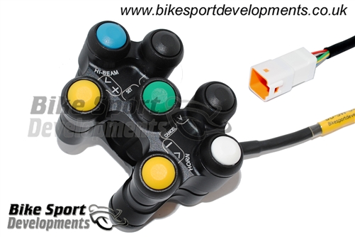

Bike Sport Developments - Plug and Play Road and Track Switch Pod - Ducati Panigale 1199R / 1299 / SuperLeggera (2015+) - BD_SW_8B_03
Bike Sport Developments - Plug and Play Road and Track Switch Pod - Ducati Panigale 1199R (2015+) / 1299 / SuperLeggerawww.superbikeunlimited.com

Initially, I never want to replace the switches because I just don't like the colorful button because it reminds me of the button on a game console/pinball machine. Nothing wrong with game console/pinball machine but it make the bike look like a toy or sometimes like M&M candy, I mean this is just my personal preference.
Plus those colorful button looks shiny and make the impression of plasticky...
However, when I install the RCS17 Corsa Corta Master Cylinder, there is clearance issue with the stock factory right switch, so I was forced to see the options available for this switches.
I compare all the BSD, CNC, WRS and Jetprime, (and there is some other brands that I forgot), but all of them (except BSD) came in machine aluminum finish that show the "machined surface finish" (grooves from the machining process), and combine with glossy black finish, which I somehow don't like.
Those grooves from the machining process were rough and make it look like the surface have wrinkle skin... combined with the glossy black finish, made them look like GLOSSY WRINKLED Skin
I might like them if the machining grooves are finer like Motocorse machined finish though...
Anyway, only BSD came with SMOOTH aluminum finish plus it's anodized in MATTE black finish which make it look more professional to my eye.
And not only that, but the BSD also mount to the master cylinder which save more space and looks cool, plus I can add more ProTi bolts to contrast it
oh, also BSD Laser Marking also looks very racing professional.
oh, and not I also remember, if you look closely at the actual button, the BSD buttons are finished in matte color which I like, plus the center of their button is FLAT (for more tactile feel), while the other brands have shiny button with full round surface (no flat area on the center).
Then when I contacted BSD, they were willing to produce a switch with all BLACK button which make me even more excited because I just can't stand the colorful M&M candy look...
So all the above was the reason why I choose BSD.
Now, I was thinking of using BSD for the left side switch too, however, BSD does not have offering that include turn signal and horn function, their offering is fully designed for track bike.
Since I want my bike to have turn signal and horn function because I want my bike to look like a street bike, then I can't replace the left side with BSD. I actually ask BSD if they can produce a version for street use and they say the demand is just not enough to justify their development cost.
