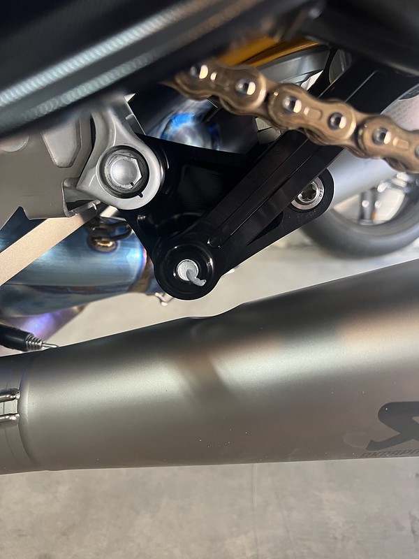

Forsaken Motorsport linear link

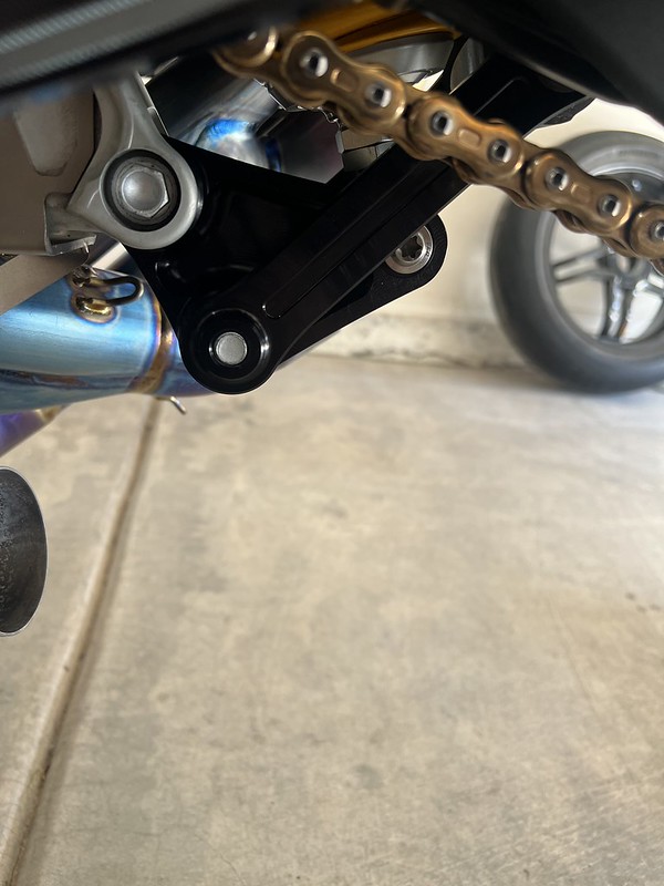

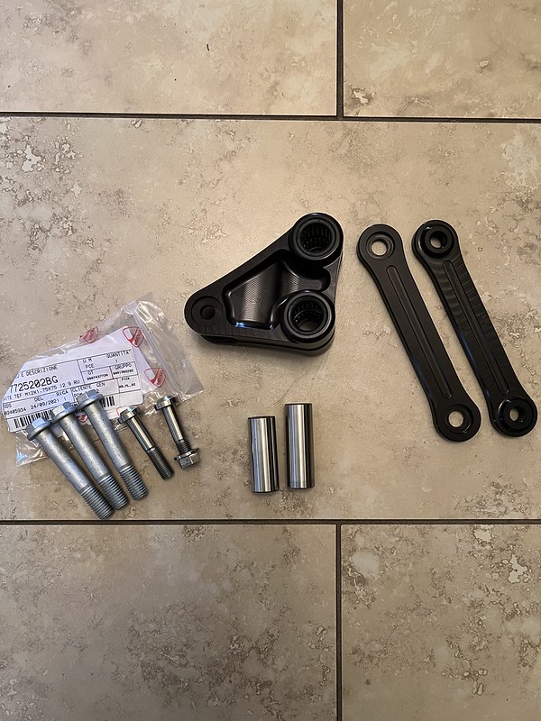

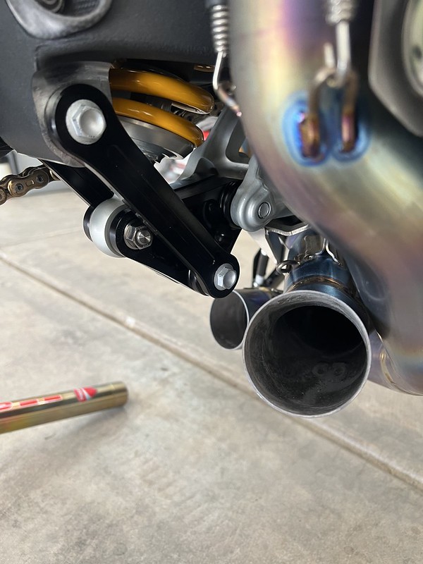

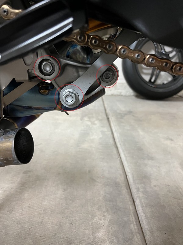

I don't have any experience with this link on this platform but on previous bikes a linear link makes a big difference.

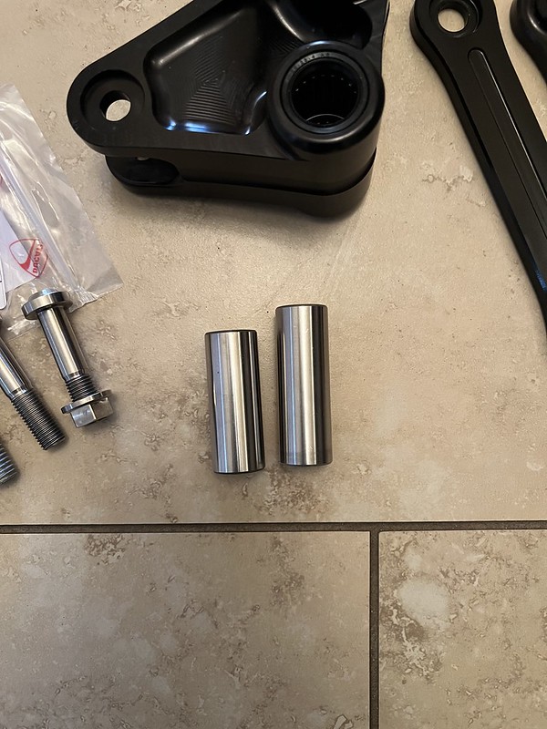

The link plates are different from the factory setup one of them is threaded which eliminates the need for a nut. The machine quality and the fit and finish is pretty good.
I opted to buy new oem hardware and linkage spacers. These can be reused but I generally don't like to reuse hardware.
OEM part #
Bolts 7725202BG X 3
Short spacer 7131C701A
Long spacer 7131C691A
I replaced the upper and lower shock mount bolts with the Proti equivalent
The linkage spacers came a dull and rough so I sanded and polished them so they glide smoothly.
Install coming soon.
