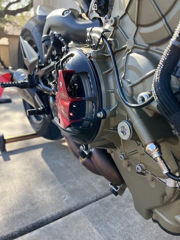

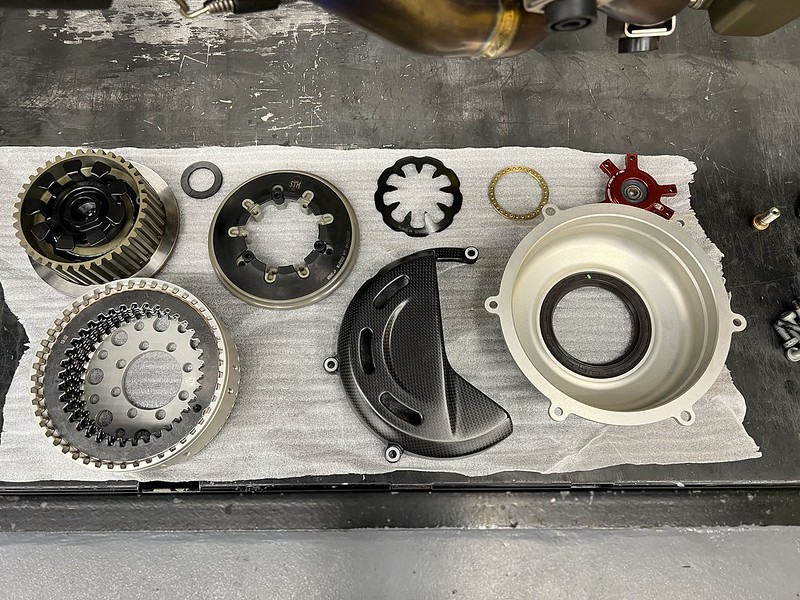

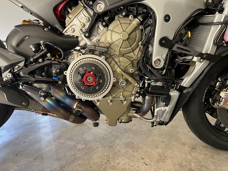

STM DRY CLUTCH # 96080031AA INSTALL

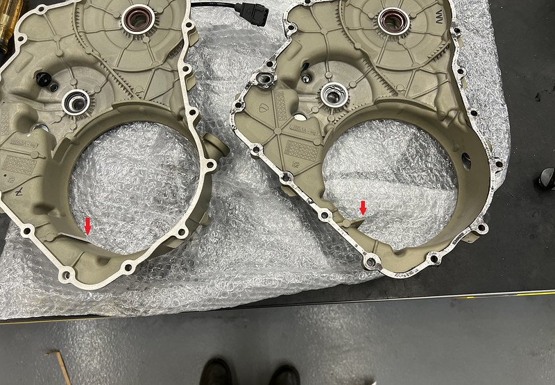

The day has come my bike will become a "real" Ducati. Here is some supplemental info about this kit. If your Vin # falls below ZDM1100W4#009397# you will need to buy a engine case. Part # 243P0041BH. I bet you're thinking why would I need another case when I already have the 2 piece case design. Apparently on the early models the case has some extra metal that will prevent the "cereal bowl" from sitting flush. On the new part # that metal is machined down. Other than that the cases are the same.
Just look at it.🤩
Start up
Just look at it.🤩
Start up
G O R G E O U S 🤩

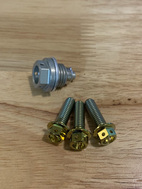

While doing the Dry clutch also did the annual service. So I did some upgrades.
Aella Oil cap and Probolt Gold Ti hardware

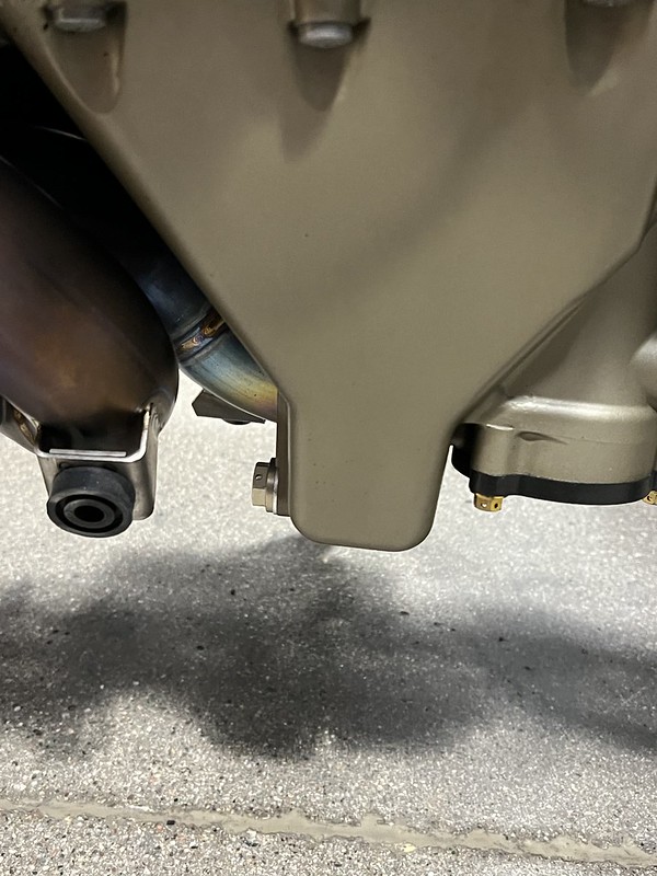

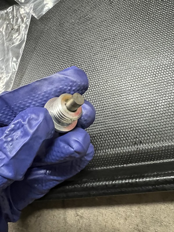

Here is the factory oil plug after cleaning the oil and Threebond off. There were zero metal shavings on the magnet I don't know if that's a good thing or should I be worried :ROFLMAO:

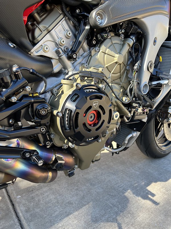

Finished product

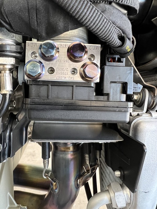

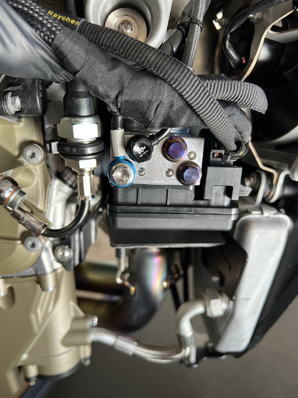

The keen eye would have noticed in the dry clutch video I don't have the lines going to the ABS box. In a effort to simplify and clean up the bike I went straight from the caliper to the master. So that means several things first I need to block off the ports on the ABS box. Secondly I will need a new custom length rear brakeline.

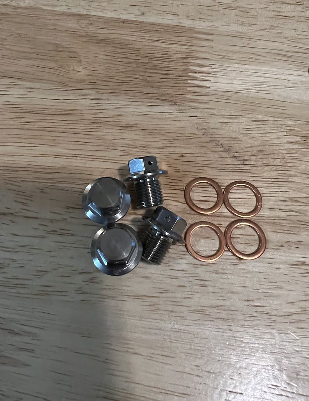

Block off bolts.
These are Ti and drilled for safety wire
Not going to leave them plain come on. Torched them purple

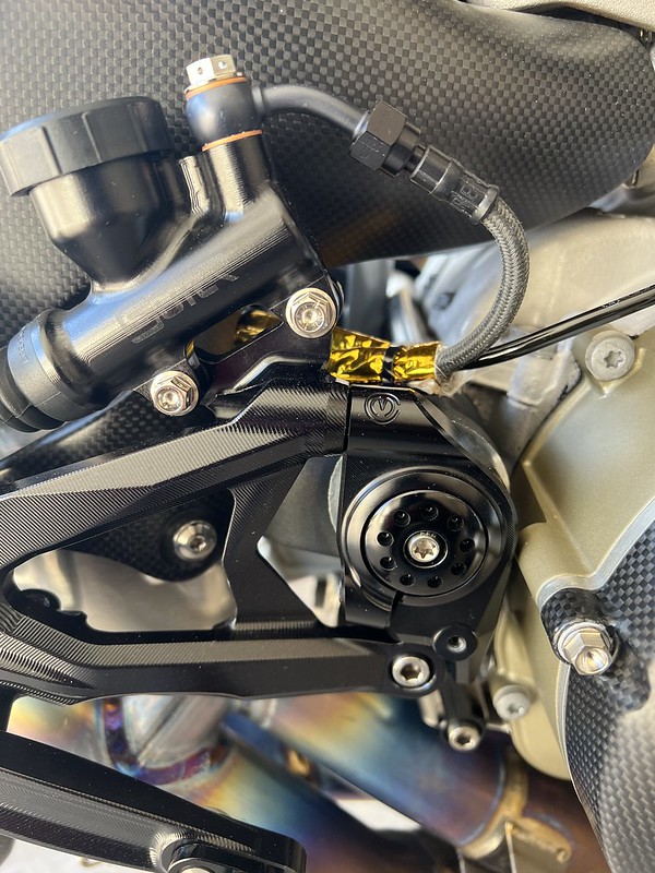

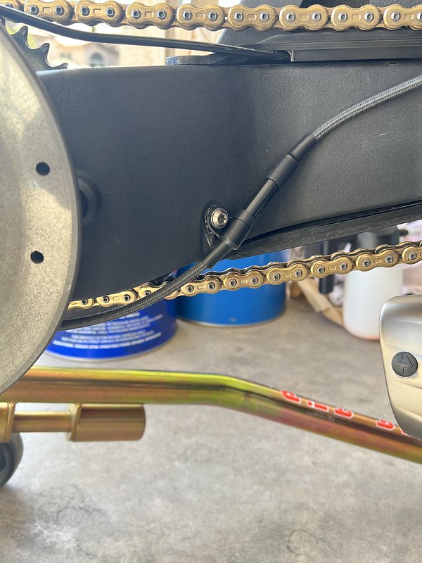

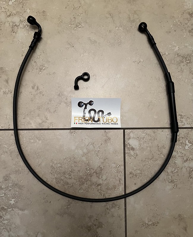

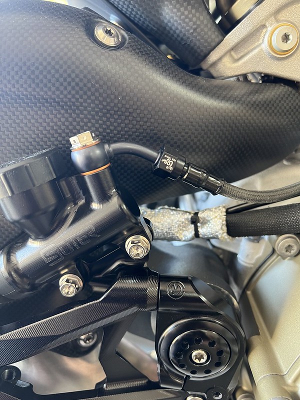

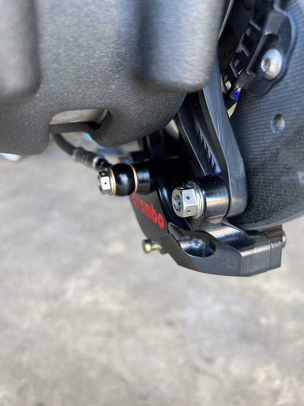

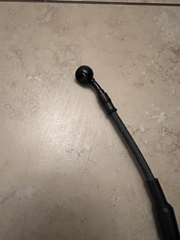

Fren Tubo custom rear line
I bought 2 different 90deg fittings for the master cylinder end. Both of which were too close to the master. So I ended up using the 45deg fitting I already had on there.

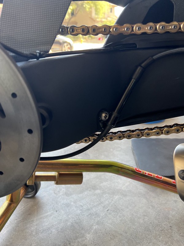

So the specs I went with are 25deg on caliper end 915mm center to center and 45deg rotatable fitting on master end.
Here is setup before ABS delete.
Current setup

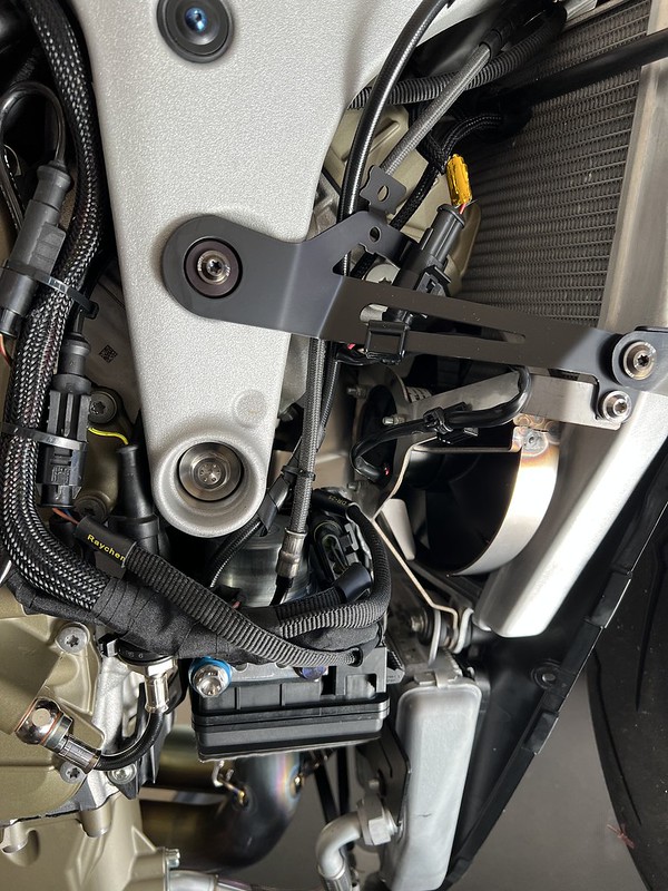

I changed the heat protection to gold 🤩
I chopped up the carbon bracket a bit more. No errors on the dash and no leaks job done.
My rear brake was ridiculously squishy and borderline useless while the ABS was hooked up, no matter how much I bled it. Instantly became functional with the ABS delete.

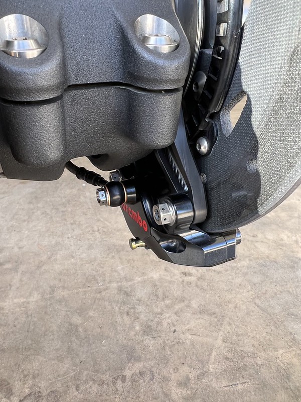

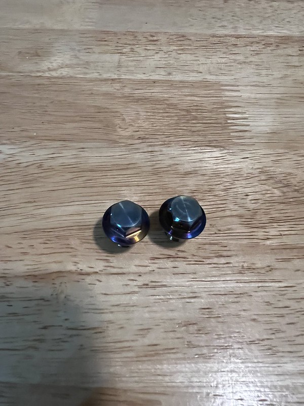

Front ABS delete
After deleting the rear and cleaning up all those lines. I was left with this. Not as clean as I would like.
So to get more braking feel and simplicity we are deleting the front. Two more Ti plugs these I burned to a Aqua color.

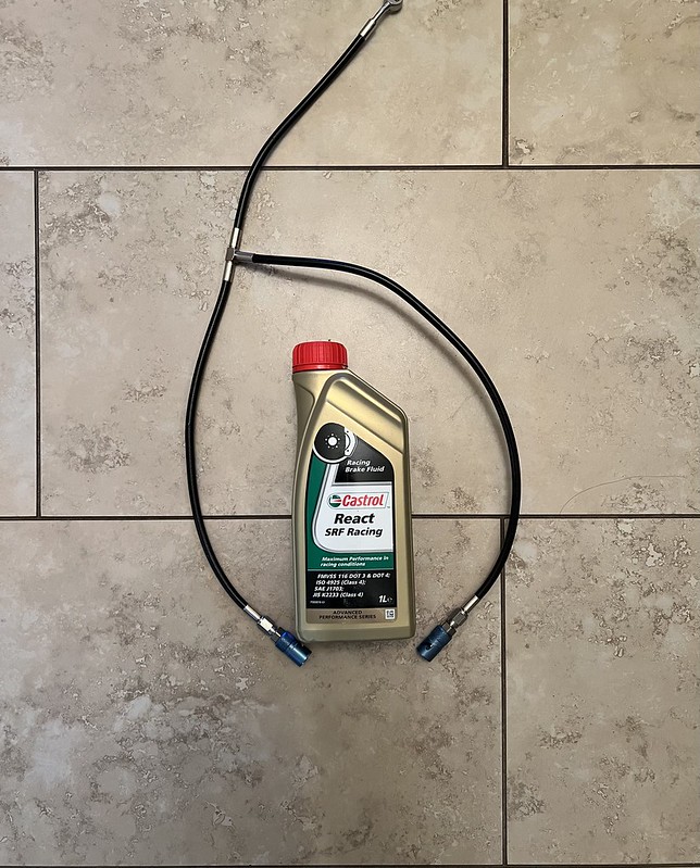

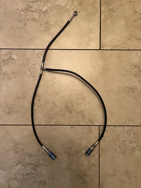

I will need a new front brakeline as well. Easy. I contacted our forum sponsor Brad @MOTION SBK. He had me send my line in for customization.
He got the line altered for my setup and back to me in less than 2 days excellent service. 🥳
I'm going to bleed the fronts this weekend if time permits with Castrol SRF

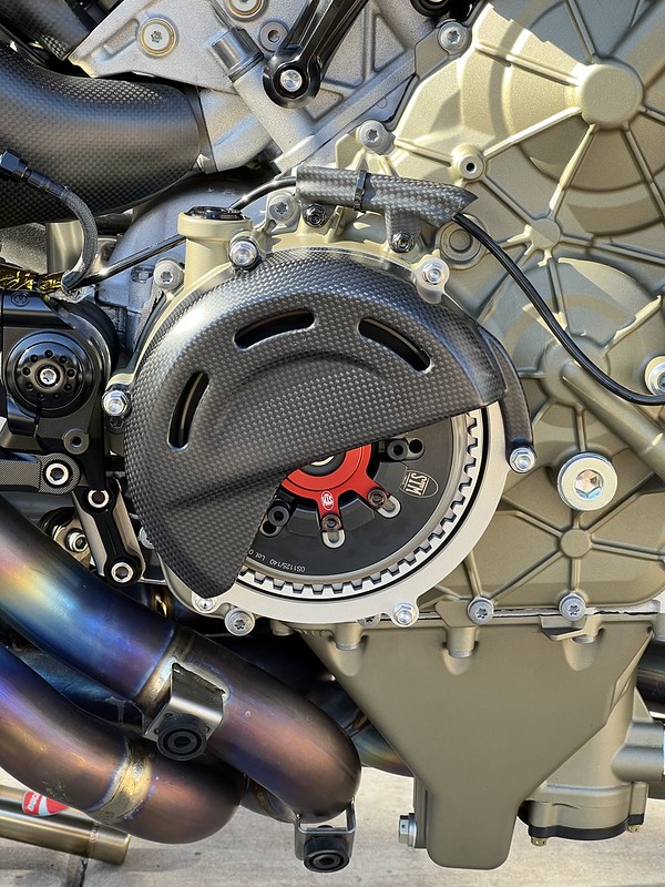

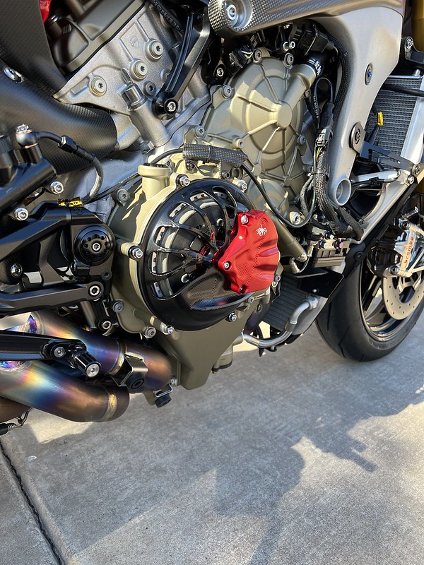

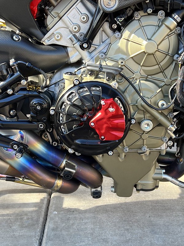

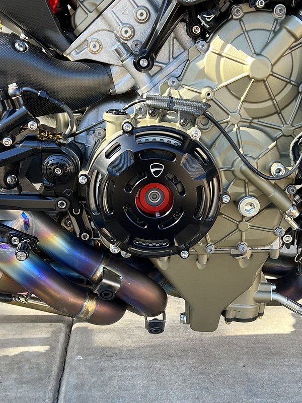

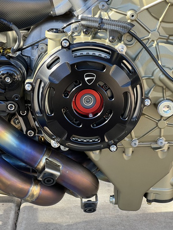

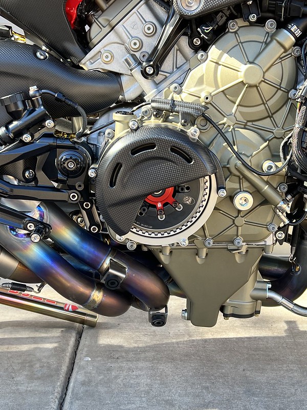

Clutch Cover Craze part 2.1
Back by popular demand! Now that the STM dry clutch is installed its time to pick your favorite cover.
We start with the DP Carbon cover.
