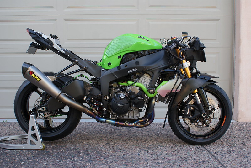

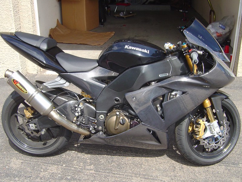

I know I have added a lot of carbon but I dont want to do all carbon again. Mainly because the body lines get lost with the dark color.
This is my all carbon ZX10R 378 lbs wet 192Hp built motor no traction control death machine. The carbon tail and tank are in the box in the background. This is circa 2004
Jaret campisi who. I've been doing the lightest fastest superbikes on the road before youtube lol jk.
This bike tried its best to kill me every time I rode it. ha

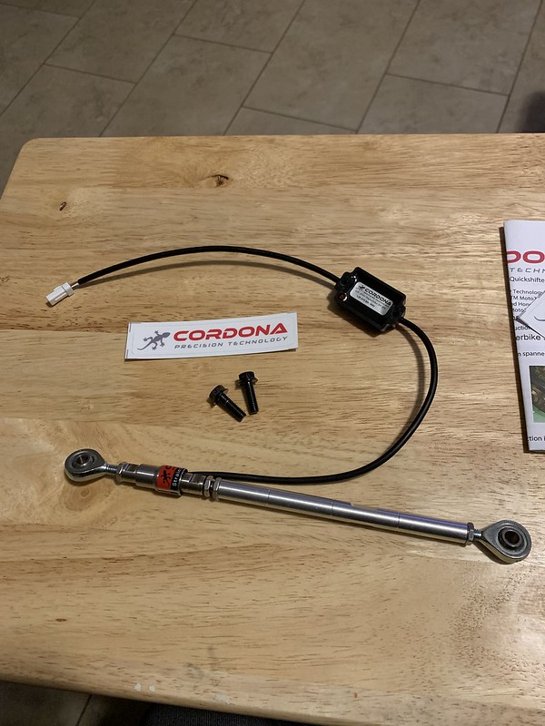

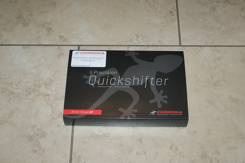

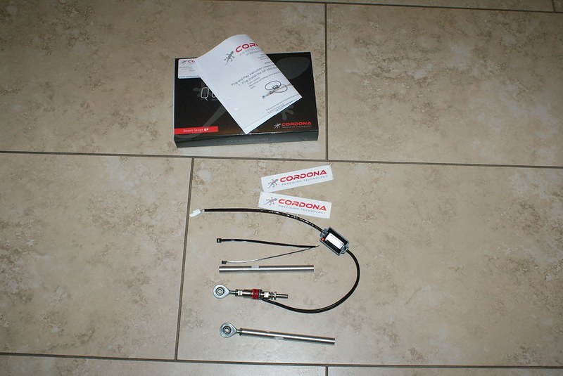

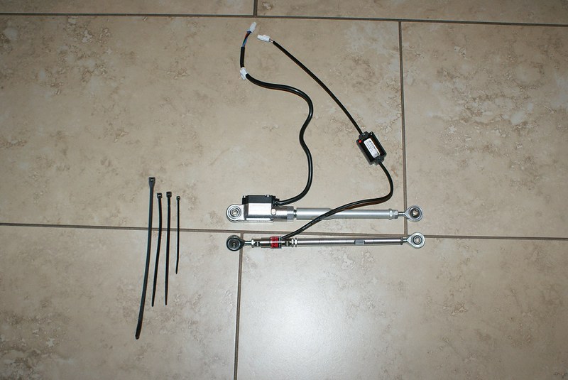

The Cordona QS
What's in the box

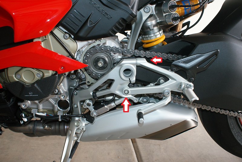

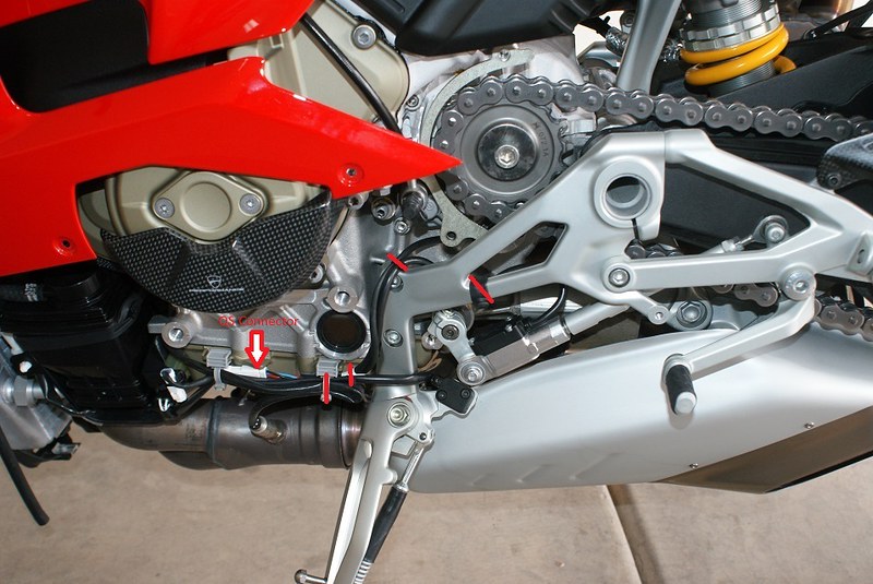

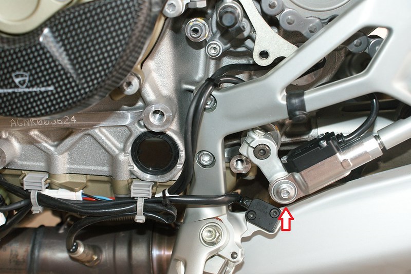

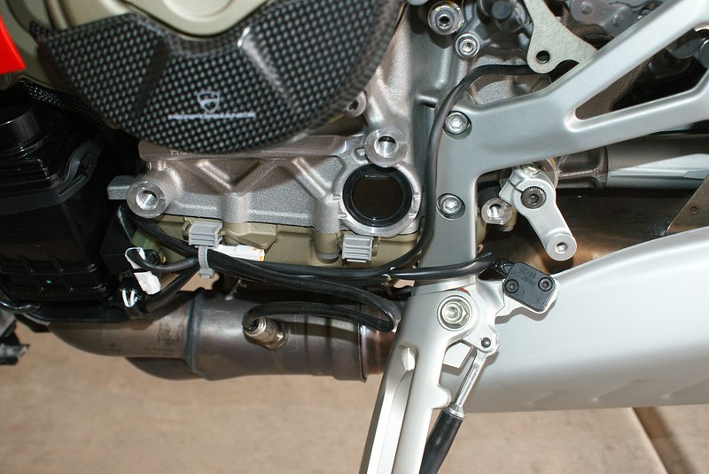

After taking off the left side lower you should be left with this. You’ll see the factory QS connector and the placement of the factory cable tie and wire ties.

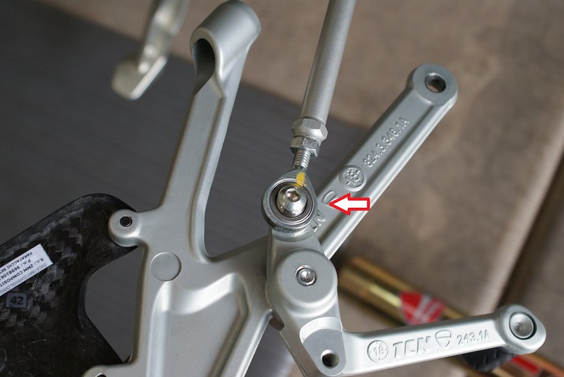

Loosen the bolts for the rearset.
Now remove the bolt on the gear shift lever.
Remove the bolts on the rearset you loosened earlier. Flip the rearset over and remove the last bolt.
Remove the cable and wire ties
Unplug the connector for the factory Qs.
Here's the factory and Cordona QS side by side.

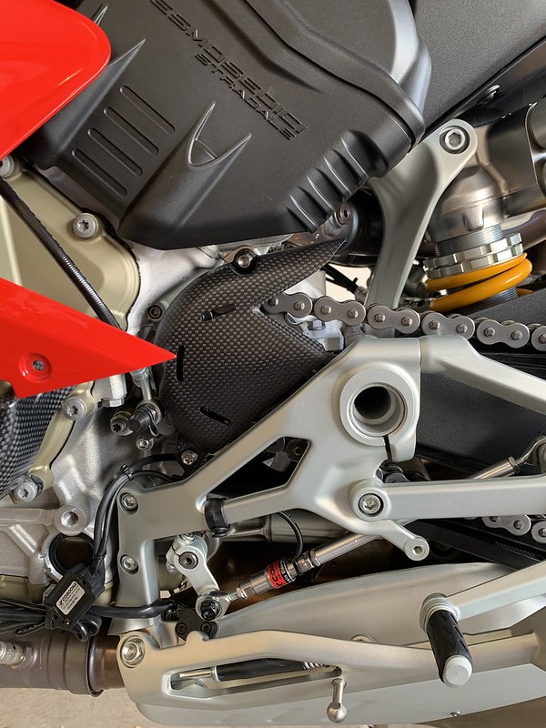

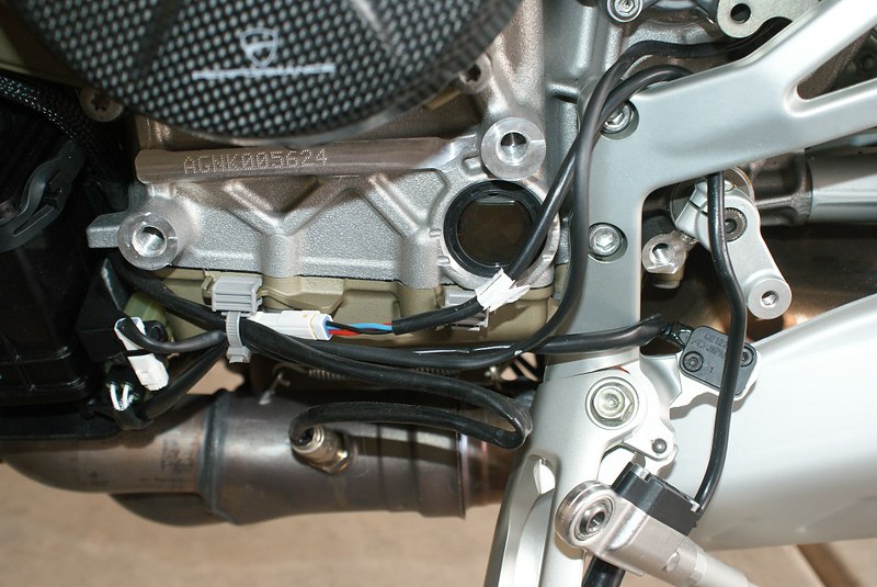

Now install your new QS.
Here is how I tidied up the wiring.
When reinstalling the bolts I used blue loctite.
The 2 6mm bolts are torqued to 10Nm
The 2 8mm bolts are torqued to 25Nm

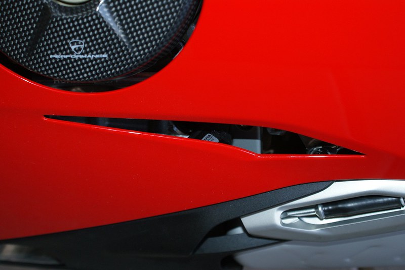

Be sure to leave room for the sensor to get airflow.
All Installed

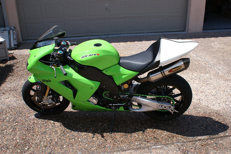

Heres one of the old Kawi's
Custom carbon endurance bodywork & carbon tank painted green
Marchensini Ohlins brembo akra superbike swingarm etc.
Circa 08'

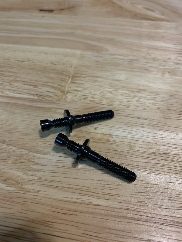

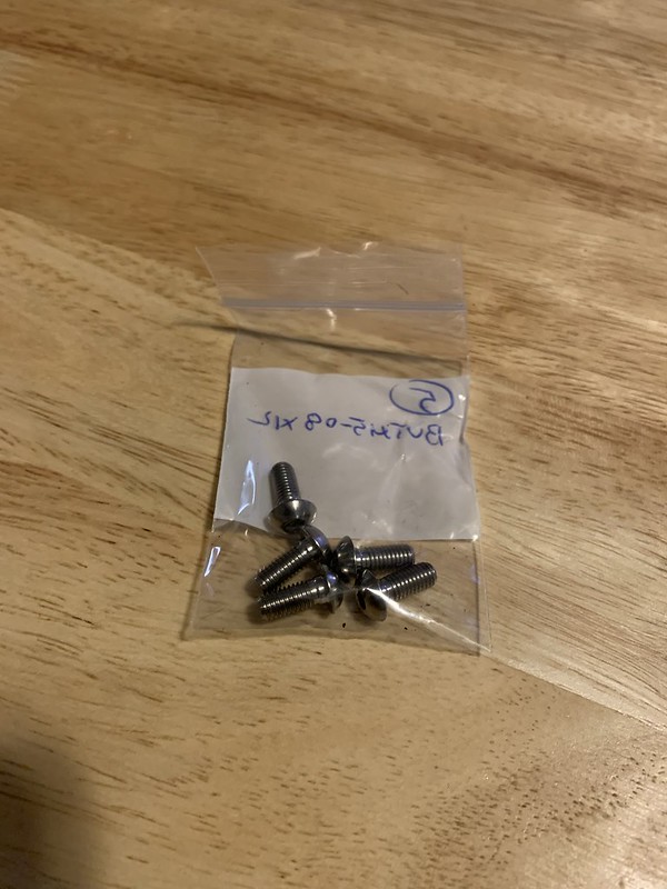

Titanium hardware
I wanted to give the bike a more premium look so I found another company that sells Ti bolts for the V4. These are from Podium racing after receiving my order from them I noticed they are local to me about 5 mins away from my house lol. I got their ignition stud kit with the top nut. I've always been a fan of the "dimpled" look on the bolt head. I think the first time I saw that was on a Aprilia RSV mille.

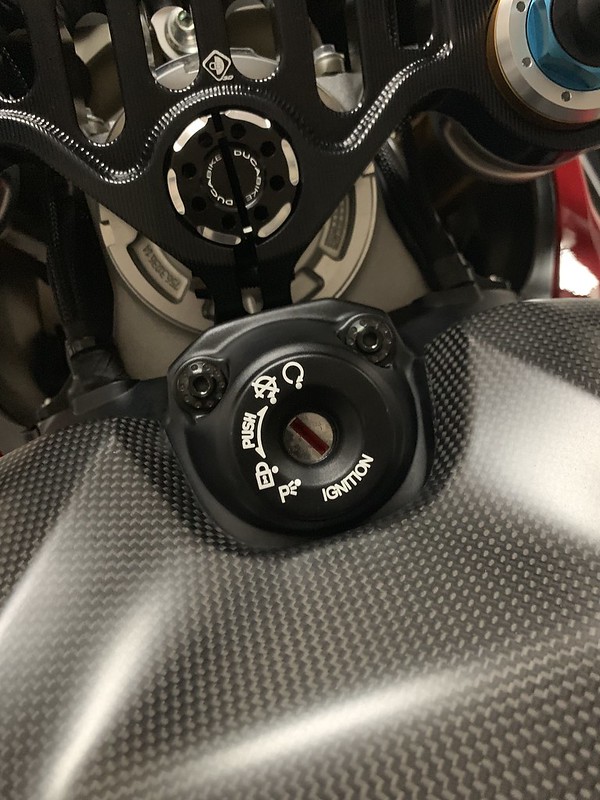

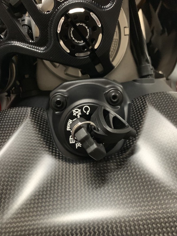

Before
After

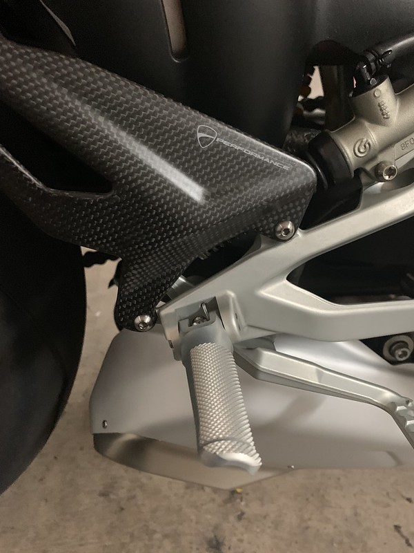

Also got some bolts to replace the carbon heel guard bolts

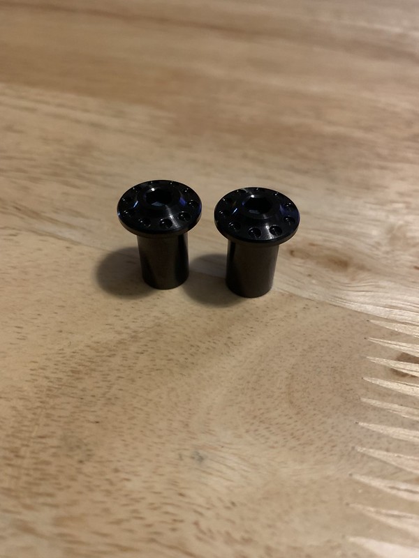

I got these race spec drilled and hollow bolts from podium racing. They look really awesome and will save some precious grams.

To every readers, please pay attention to what @HKMP7 said, especially on the word HOLLOW
because that Podium Racing bolt is really HOLLOW all the way through the middle of it !!! That's is amazing 🧐
I am guessing they were using gun drilling method to create that long holes ...
