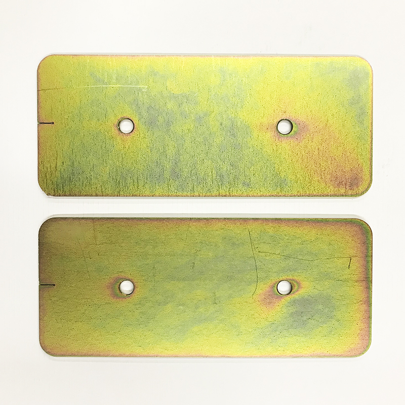

I went to modify the spacer with rectangular style spacer to fit between the underside of truck bed ribs, to gain more coverage (which was also discussed with pit bull staff)
Hi Tsaico,
I think it would also help to use round washer between your rectangular spacer/plate and the Nuts, because right now, the Nuts only cover very little area so the pressure in that small area is very high.
Tsaico
FOUNDING Member
Hi Tsaico,
Hi Alpina, yes that seems sensible, I will try that, and thank you!!
