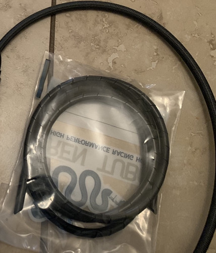

So I got these in today. The car note has carbon fiber lines. Went with this brand because they’re already measured and fittings have the correct angles. Took the lazy way out.
but, I didn’t know this clear line cover was goinf to look grey....I think I’m just going to cut it off. Would there be any problem with doing that?

Hi Lucati,
There is no problem cutting the clear line cover, just becareful not to cut too deep and "injured" the carbon braided fiber beneath it.
The purpose of this cover is to prevent small dust/dirt/road grimes embedded between the carbon braided fiber which can slowly get into the inner PTFE tubes and damage them...
or in case if you are using stainless steel braided also avoid the stainless steel braided from making contact with any other surface of the bike causing scratch on the other surface.
You can always painted the clear line black (or any other color), just make sure you are using a flexible paint so they won't peel off easily if you don't want to cut it.
+1 on cutting it off.
No issue doing that just be sure to protect the lines anywhere its going to come into contact with something. They sent me this protective wrap with mine.
