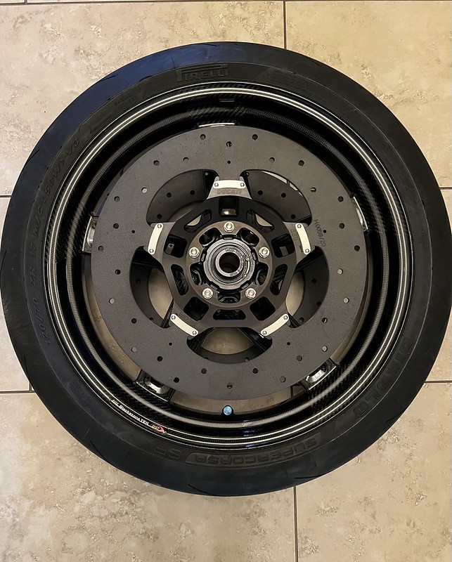

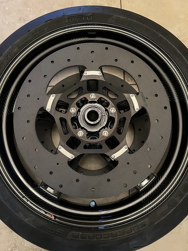

Sicom DMC 330mm T-Drive Rotors

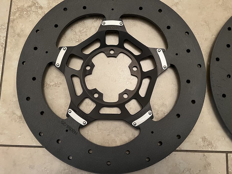

The latest addition in the weight savings journey brings us to these insanely light rotors. These are the best of both worlds you get the low weight like the carbon carbon disk used in MotoGP. But you get the flexibility of being able to use these at much lower temperatures. Like a lot of modern super cars with carbon ceramic brakes these will even work in cold conditions. The machining quality on the rotor hats is excellent and the anodizing is great. The rotors come with their own pads.
Now the pictures!

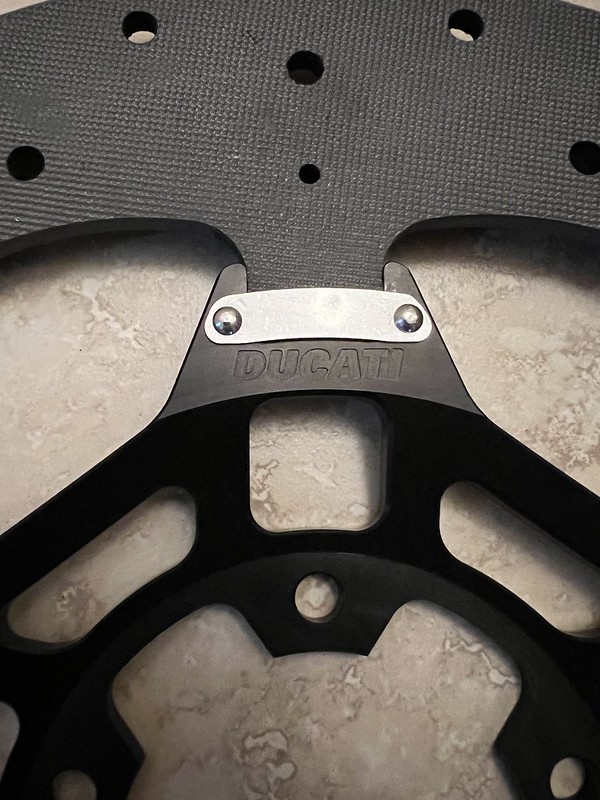

Love how they put Ducati on the hats.

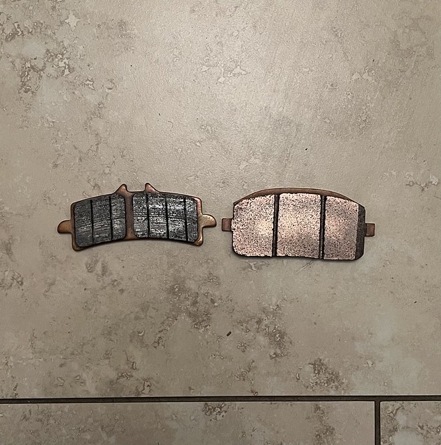

Here are the pads they come with. Notice the pads have a lot more swept area than the stock ones.
These are the bed-in instructions.
Weights & Measures
Sicom DMC T-drives 663g Left 663g right 1326g total
So I'll save 4.1lbs by going from my current Braketech rotors to these.
Recap
Stock Rotors 1376g Left 1381g right 2767g total
Braketech Iron 1599g Left 1611g right 3210g total
Brembo T-drives 1583g Left 1586g right 3169g total

plus, I love the hexagon bolt idea rather than torx
Yeah I like these because I may switch between rotors often.

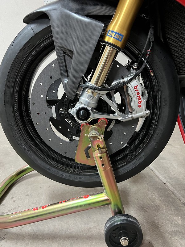

"Bedding-In"
I need to get the rotors and pads bedded-in. Since I don't have any track events coming up I will have to bed them in on the street. Sketchy af lol. I loaded up my backpack with a pump sprayer more on that later. I decided early in the morning would be the best time since there will be less traffic and no 👮‍♂️. To my dismay there were 👮‍♂️👮‍♀️ everywhere lol. So in between my sightings I would bed the brakes. After the 10 stops from 50 mph which were easy I started on to the 100 mph stops. I now have somewhat of a lever and the bike stops decent. The initial bite isn't like the Braketech Iron rotors but these ramp up like crazy. During the 100 mph stop the ABS would activate which I've never felt on this bike. Its not unsettling like other ABS systems it was a slight nudge on the lever as oppose to it fighting you. I let the brakes cool down and now we are in the home stretch. 2 more 100 mph stops then I ended up at the gas station here's were the pump sprayer comes into play. I go inside and purchase a large Fiji water I filled my sprayer with half and I drank the rest. Sprayed down the brakes to cool them off. Only the best hydration for the Sicoms lol. I could only imagine what the people at the gas station were thinking wtf 🤨.
Now that the brakes are good to go they fell great I've put about 100 miles or so on them and they stop stop.
I'm ready to out brake Toprak Razgatlıoğlu into turn 1 at Jerez 🤪🥴. I will put more miles on them and do a proper review. Initial thoughts are positive.
