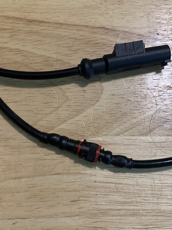

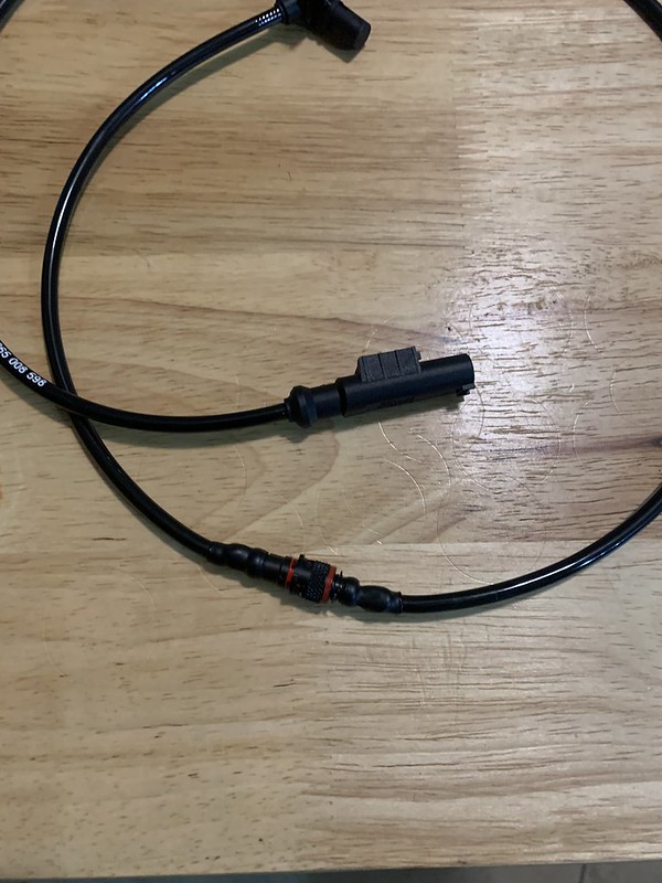

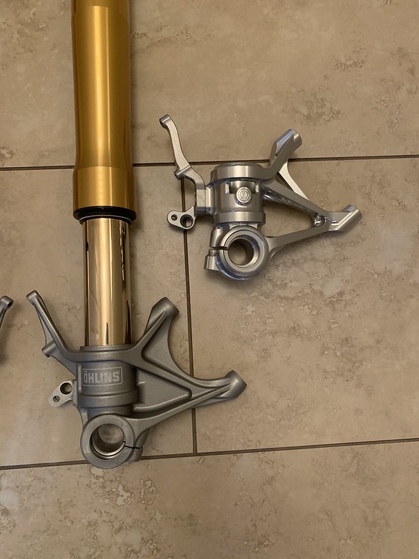

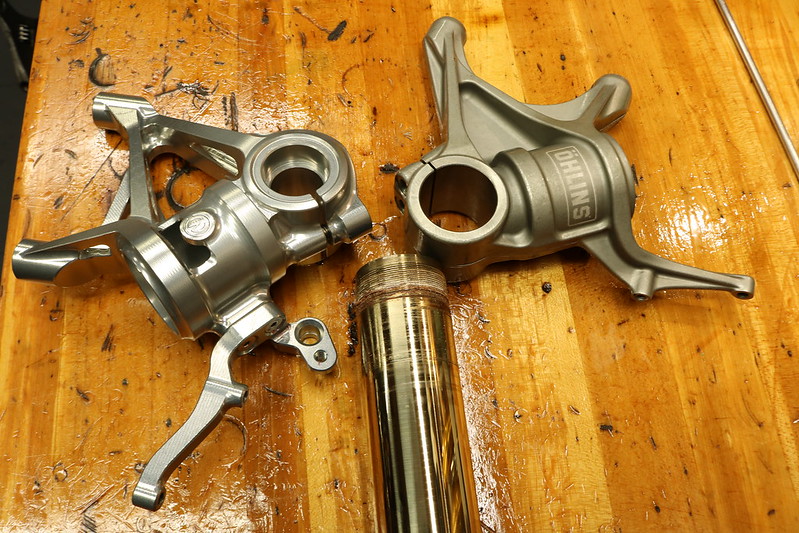

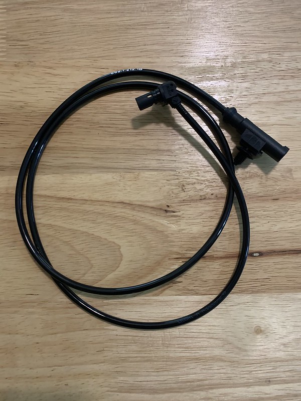

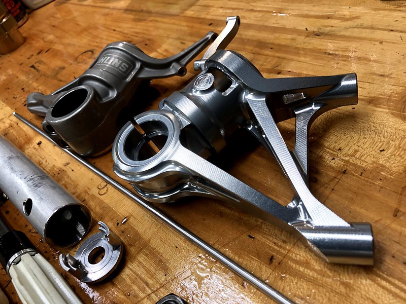

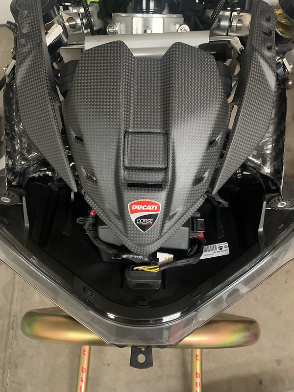

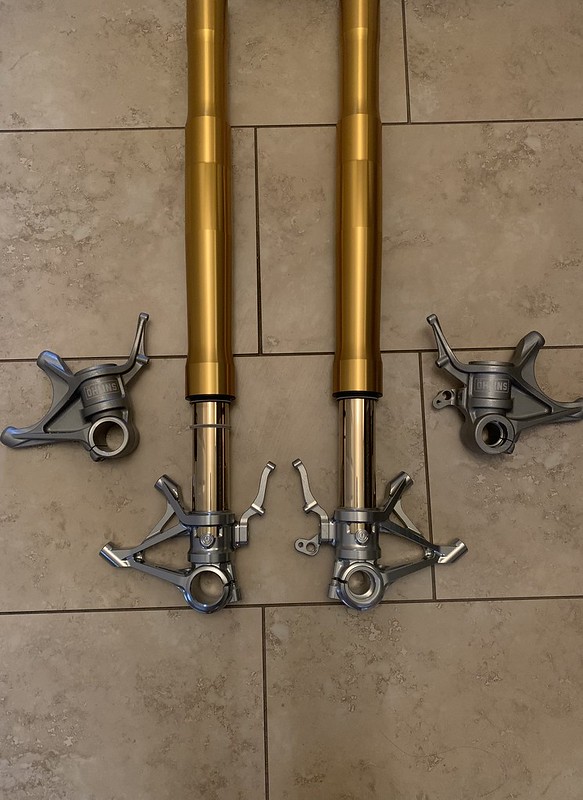

Wow, this BUILD just raised the bar at DUCATImodified to Motorsport LevelFront wheel speed sensor project
Here is were we started

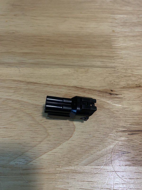

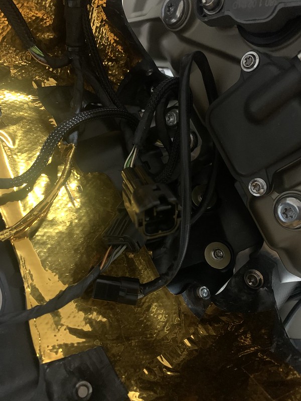

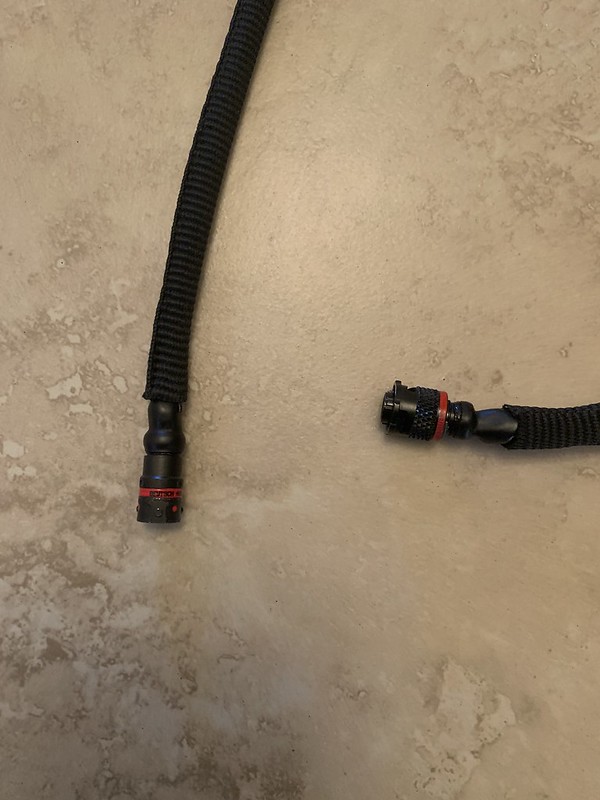

Adding a Deutsch ASU autosport connector
These are the same connectors used by all high end motorsport teams in Formula 1 MotoGP and WSBK.

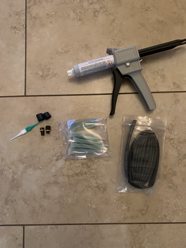

Here are some of the specialty tools needed to install the connector.
Installed

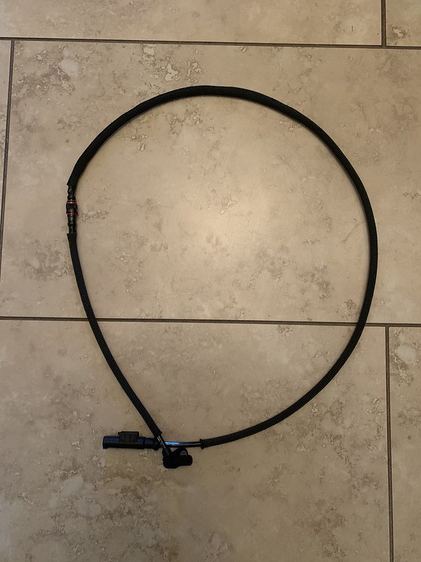

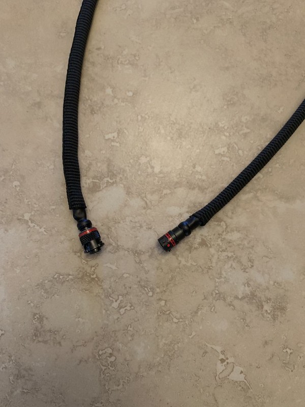

Now we loom. I used a mixture of Raychem DR-25 US and Raychem HFT5000. If you've never used this stuff its incredible chemical abrasion and heat resistant.
Heat resistant up to 302 deg for 1000 hours. Crazy stuff.

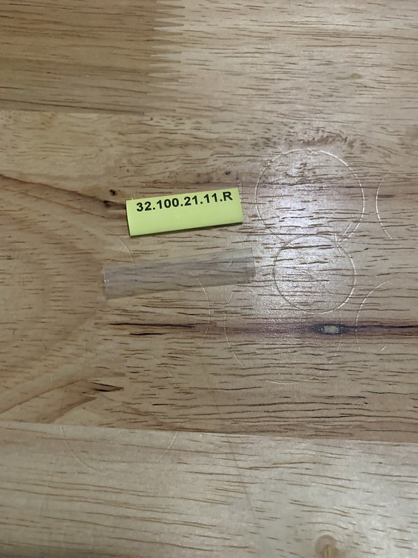

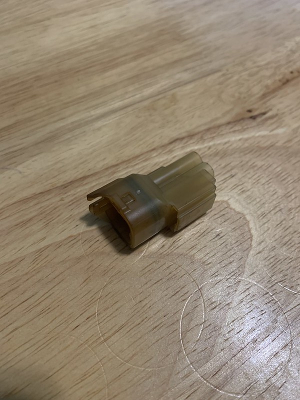

I wanted to add my own touch since its my custom part I came up with a part# 32.100.21.11.R
Any guesses on the significance of those numbers?
Makes maintenance easier if you needed to remove the front end. They are more durable and lighter than plastic connectors. Last longer in extreme conditions. All great features none of which really apply to me lol. I did it for a couple reasons first it looks cool second I get practice making them for a up coming mod.What’s the advantage of the Deutsch ASU autosport connector?
