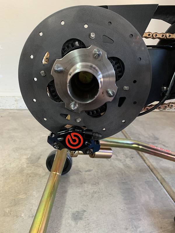

You need a billet master cylinder now to complete the MotoGP spec brake setup.![]()

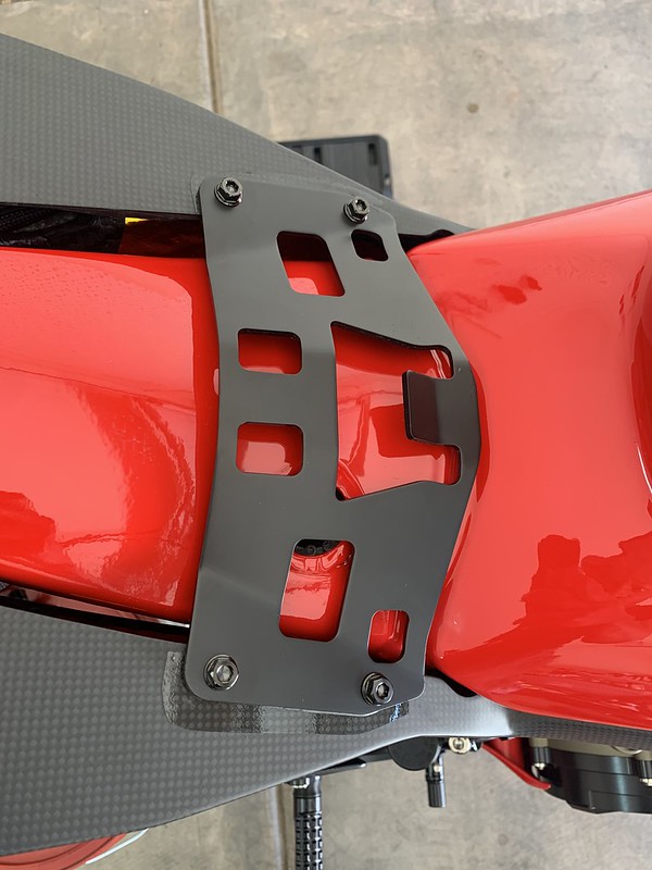

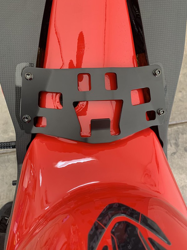

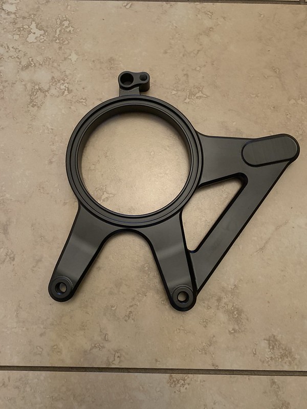

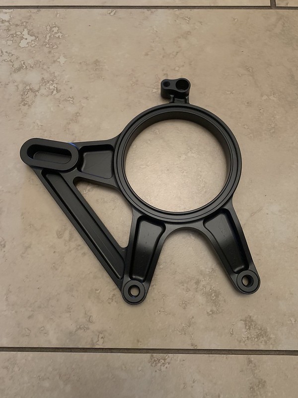

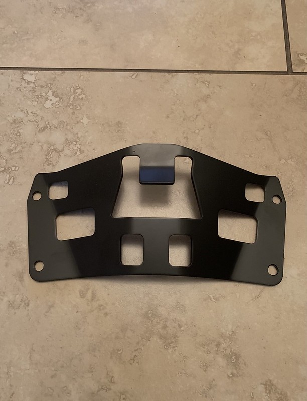

Wow, I never seen a black color Cerakote before, that is very beautiful, the way it was spreading on the surface, more like anodized instead of paint !Cerakote done
So I got a couple parts done in satin black. The finish looks great and should last a long time.
Im going to test fit the V4SL caliper bracket soon to confirm fitment.
Yeah it’s really hard to tell the difference between Cerakote and Anodizing.Wow, I never seen a black color Cerakote before, that is very beautiful, the way it was spreading on the surface, more like anodized instead of paint !![]()
Agreed. I had the brackets the rear sets bolt to coated and it makes such a difference.Yeah it’s really hard to tell the difference between Cerakote and Anodizing.

Would be awesome if you could do a track day on the stock calipers, and then another at the same track on the new calipers within a few weeks of one another, to get a back to back impression.

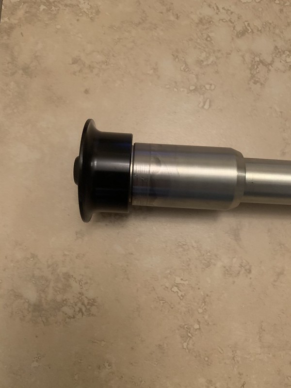

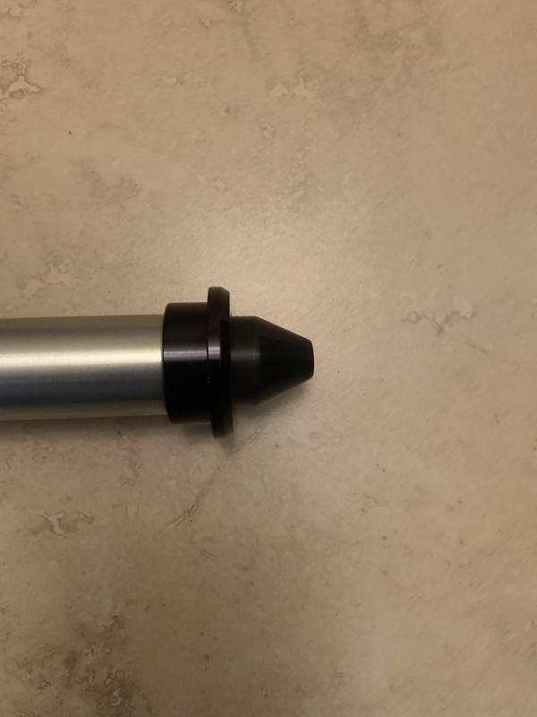

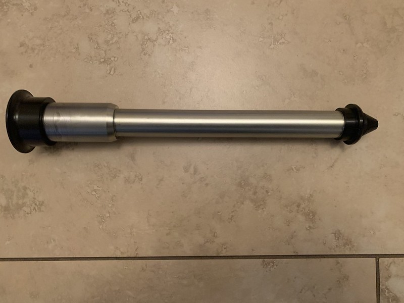

I would consider after I get my carbon wheel next....hmm...Fast Frank quick release axle
I've been trying to get FF to make a Ti version of this kit which has failed lol. So here is the standard version of his quick release axle. This allows you quickly remove the front axle without having to mess with the fork pinch bolts on the clutch lever side. The pull cup also makes the job easier.

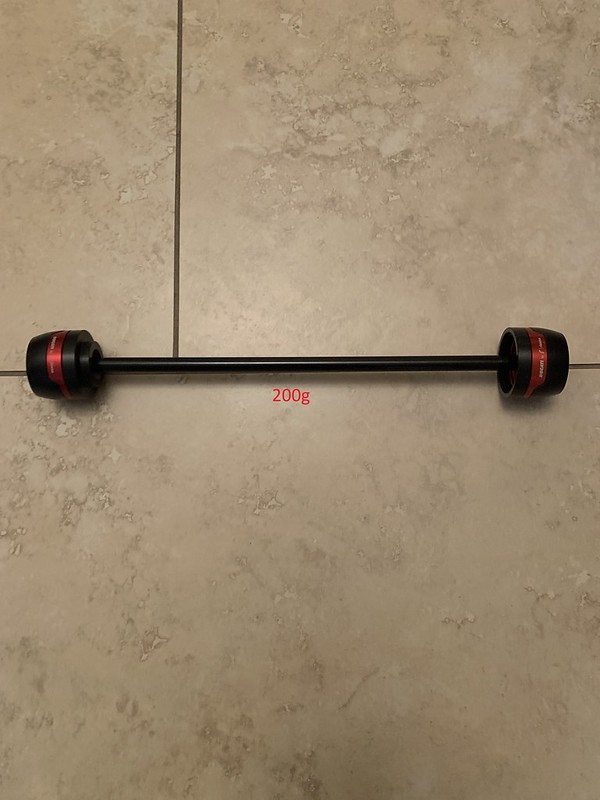

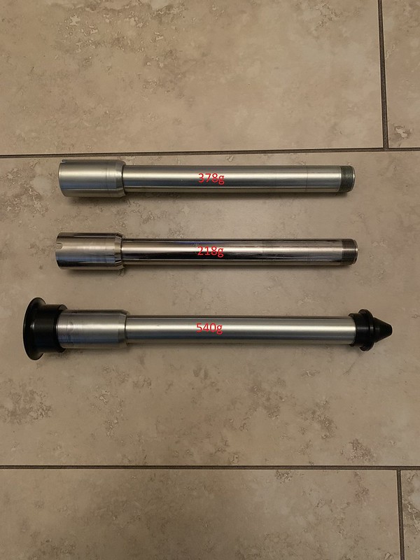

Weights and measures
I was worried that this axle would add a lot of weight but its not as bad as I thought. Like most I have fork sliders on for protection so when you take those in consideration here are the numbers.
200g
Stock Axle 378g
Ti Axle 218g
FF Axle 540g
So if you have a stock axle with rizoma sliders you are actually heavier than the FF QR kit.
Here are the totals which include the rizoma fork sliders, axle and axle nut.
Steel setup 596g
Ti setup 434g
Since I had the Ti setup this QR axle is going to add 107g which I'm ok with since it will add convenience and style.
