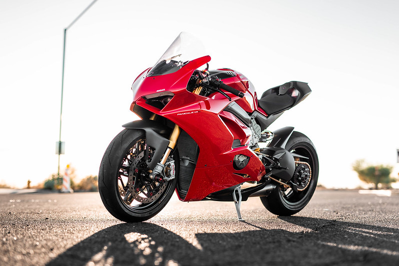

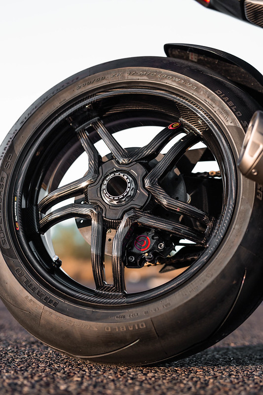

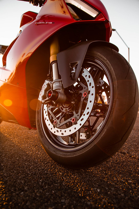

After months of waiting here they are and Wow just wow! These are in my opinion one of the greatest wheel designs ever. RIP Roberto Marchesini 🙏.
These wheels have come full circle for me I remember buying my first set in 2004 for my ZX10R. I also remember almost crashing the bike the first time I rode it with the new wheels. I wasn't expecting the bike to "turn in" so fast. At the first fast corner I inputted a little too much counter steer I almost ran off the track. 😂
Enough of me rambling on to the pictures
The details on the spokes are insane 🤯
Weights and measures
Front wheel 17x3.5 3017g/6.6lbs
Rear wheel 17x6 3162/6.2lbs
I will source some ceramic bearings for these soon they are stock for now.

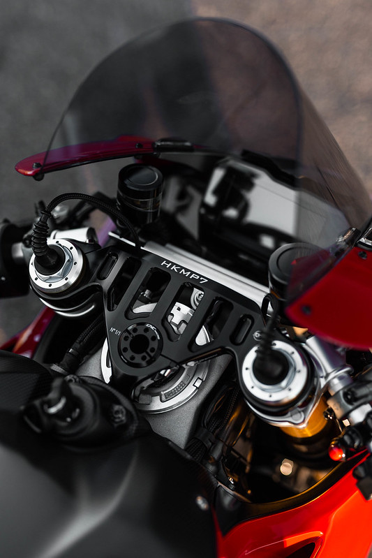

Thanks Craig! My first love was the love of firearms. They are a lot like bikes they demand a high level of respect and concentration. If you get it wrong its game over. Heckler&Koch is my favorite gun brand. This is the MP7 :love:. So I decided to mix both my love of bikes and firearms together.

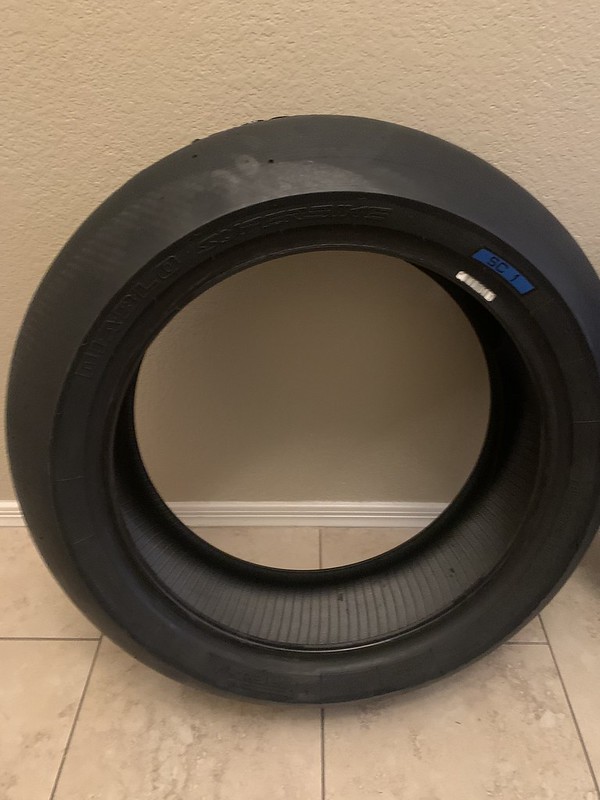

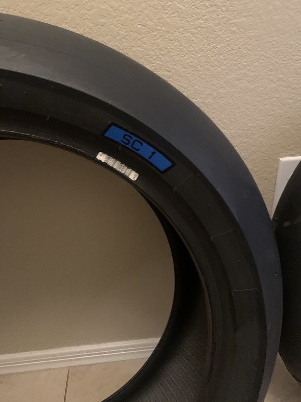

Pirelli Diablo Superbike Slicks

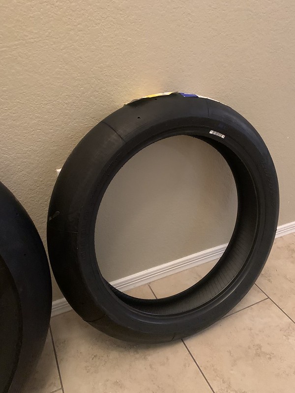

These are the Diablo Superbike slicks with the SC1 compound. These are a good balance between dumb grip and longevity. I went with the stock sizes 120-70 & 200-60. Next set I will try the new WSBK sizes 125-70 & 200-65. These will go on the Marchesini M10RS wheels.
I love the SC1 sidewall marking. Makes me feel like a factory rider lol.

You probably already have it, but make sure your SSSA stand is the correct one for the V4. The "standard" SSSA stand from Pitbull will rub against the 200/65 tire and make using warmers a pain in the ass. The one for the V4 lifts it up a little more for clearance.
Yeah I got the new version. I need to get me some new tire warmers tho. I refuse to be the guy with lime green tire warmers that say "Kawasaki" on the V4. Lol
