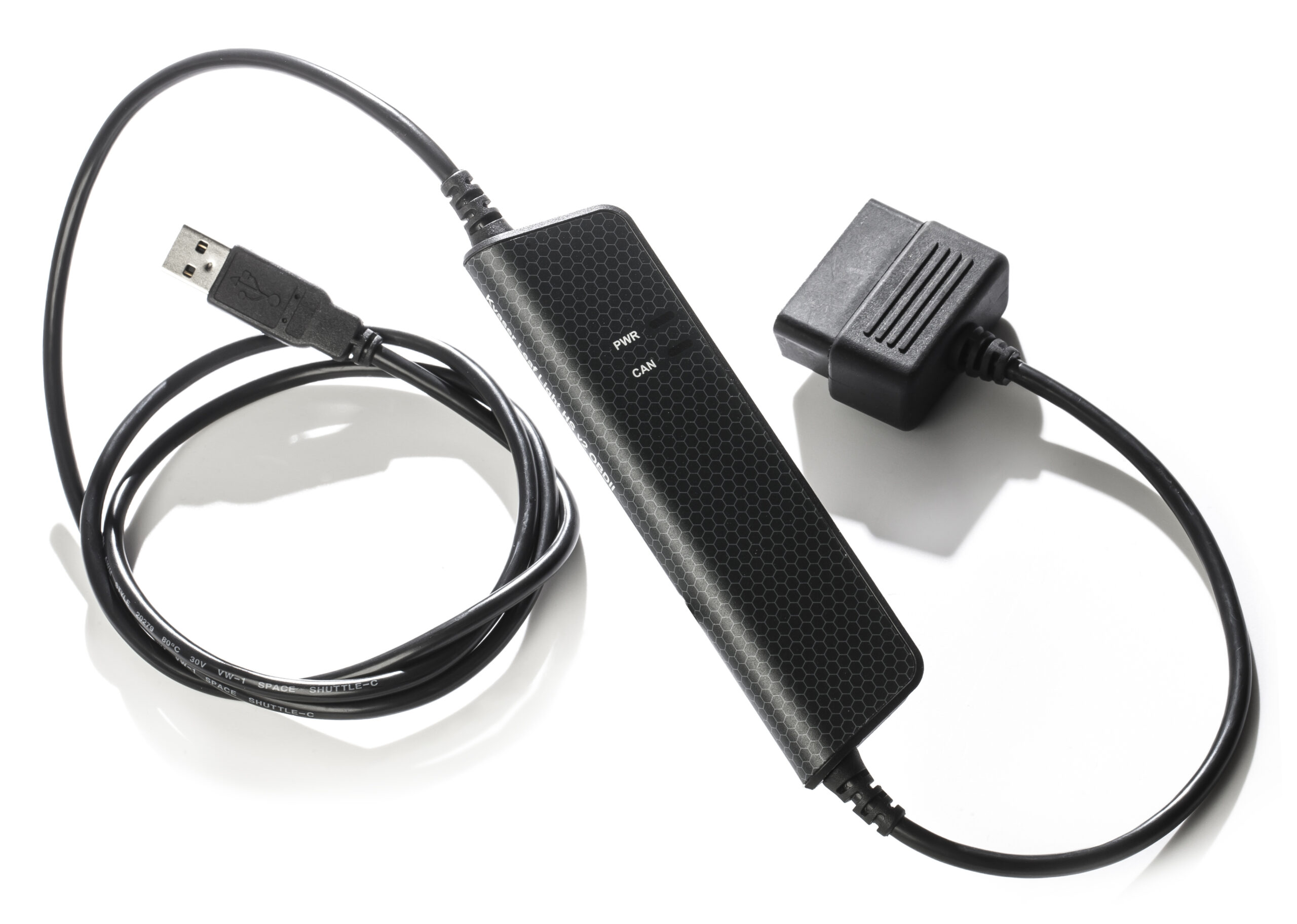

I wonder what kind of DEVICE needed to upload the new software for the BBS.
ggok
Member
To make changes to the BBS and ECU, you will need a "Kvaser Leaf Light HS v2", a CAN-Converter to connect to your PC. You will also need a cable to connect the vehicle to the Kvaser.
The ECU and BBS flashing is done with software provided by rexxer. Each mapping is also provided with a unique VIN number built in.
