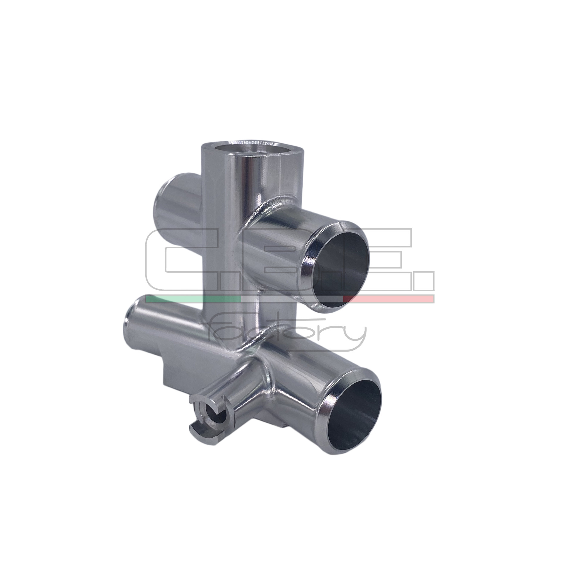

Hi MaverickiB,Disaster struck and my V4 decided it no longer liked the OEM plastic thermostat housing. It split, causing one of the hoses to detach, and purged all of the coolant it had into my belly pan. The racing belly pan did its job and kept the majority of it from reaching the track. Was only a few laps in to the first session of the day, and reaching that part takes hours of disassembly, so the day was effectively ruined. The techs there said they have seen that part fail on 4 V4s over the past few weeks, since it is just cheap plastic.
Will be swapping over to this. Recommend it if you track your V4 and don't want to splurge on a completely different radiator setup that bypasses it.
Home :: Parts :: Ducati :: V4 (18-24) :: Radiator :: CBE Ducati V4 Panigale Streetfighter Billet Thermostat Bypass Junction Adapter (2018+)
CNC MANIFOLD – THERMOSTATIC VALVE REMOVER FOR DUCATI PANIGALE V4 ALL M Y Main features Replace OEM part made by plastic that could be subject to breakages Allows the reduction of the working temperature of the engine Material AL 6082 CNC machined from solid on 5 axis machine Plug & play same...www.hsbkracing.com
Can't help but think you should have asked if it comes in gold, haha.Hi MaverickiB,
First, I am glad that your belly pan catch your coolant and you and your bike are ok.
Second, I want to say thank you so much for posting this information. This is great/perfect timing because I haven't assembled my throttle body so I can replace my plastic thermostat housing easily.
I just placed an order at HSBK racing, Thanks again![]()
I was actually thinking to anodized it in gold, but, with the constant heat from the cylinder head and the hot water coolant, i think it will fade the gold anodizing fast so I decided against that,Can't help but think you should have asked if it comes in gold, haha.
